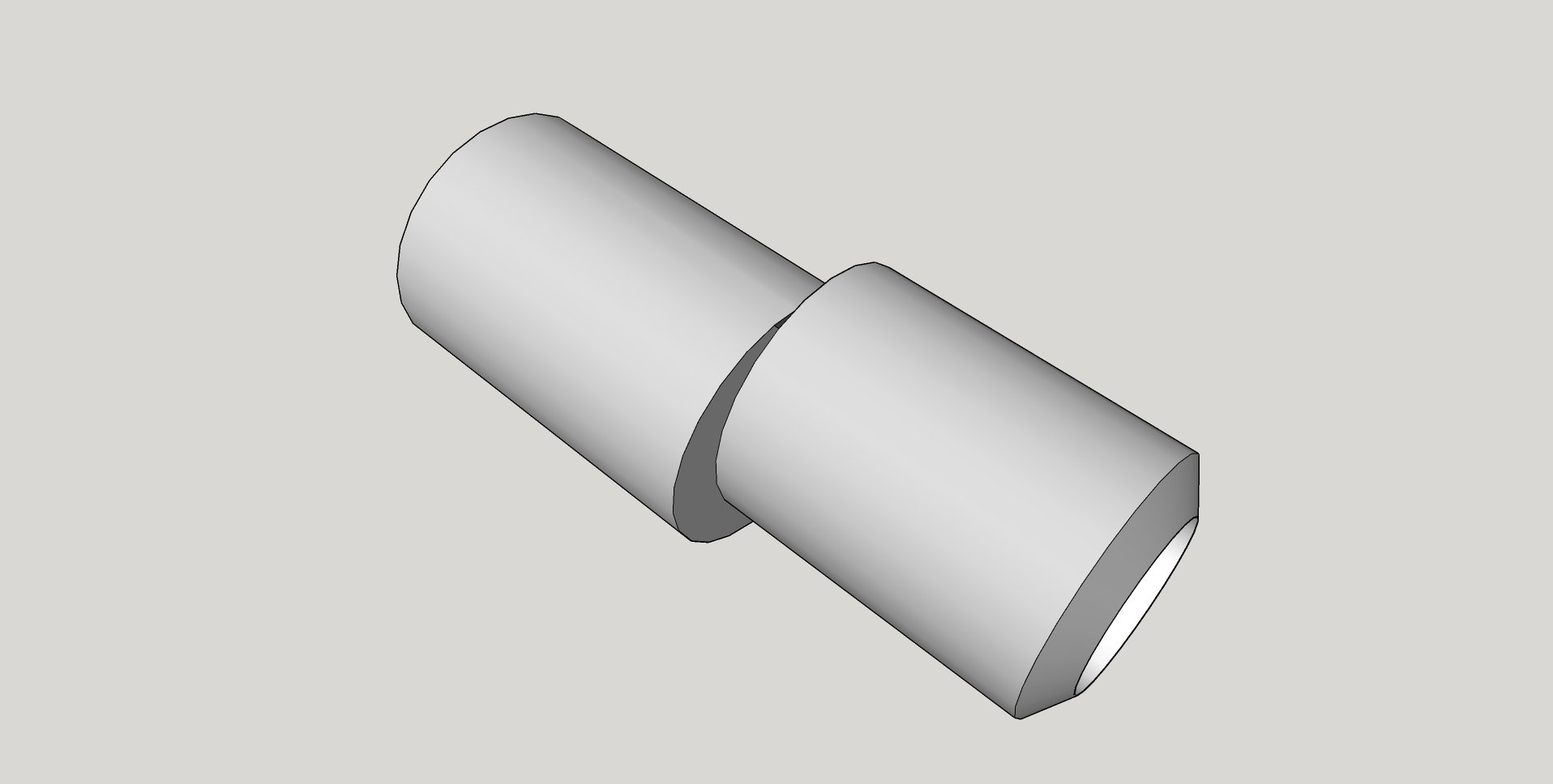

The mounting posts for your jointer should be an eccentric post with an offset near the middle. IIRC all Model 620 Jointers and on made starting in 1954 have eccentric mounting posts. The posts should be installed with the eccentric offset resting on the mounting holes of the Mark V and the Jointer set on the top of the posts. Align the Jointer's hub to the lower aux. shaft hub on the Mark V and tighten the set screws. The eccentric should always rest on the Mark V's mounting holes. This information is in the owners manual under setup.

If the posts being used are not eccentric you would most likely have an alignment problem (the hubs would not align) but that would not cause a slipping issue. You would be able to lock the jointer at various heights but would not be able to align the hubs laterally. This one is used on my jointer.
Short Eccentric
Short Eccentric

I would recommend changing to the Jointer Eccentric Mounting Tubes P/N 5020809. Having the Jointer, which is very heavy, resting on the eccentric offset would eliminate the chance of slipping down even if the lock doesn't completely hold it. Do check to see that both sides of the lock put pressure on the mounting tubes as others have indicated.
