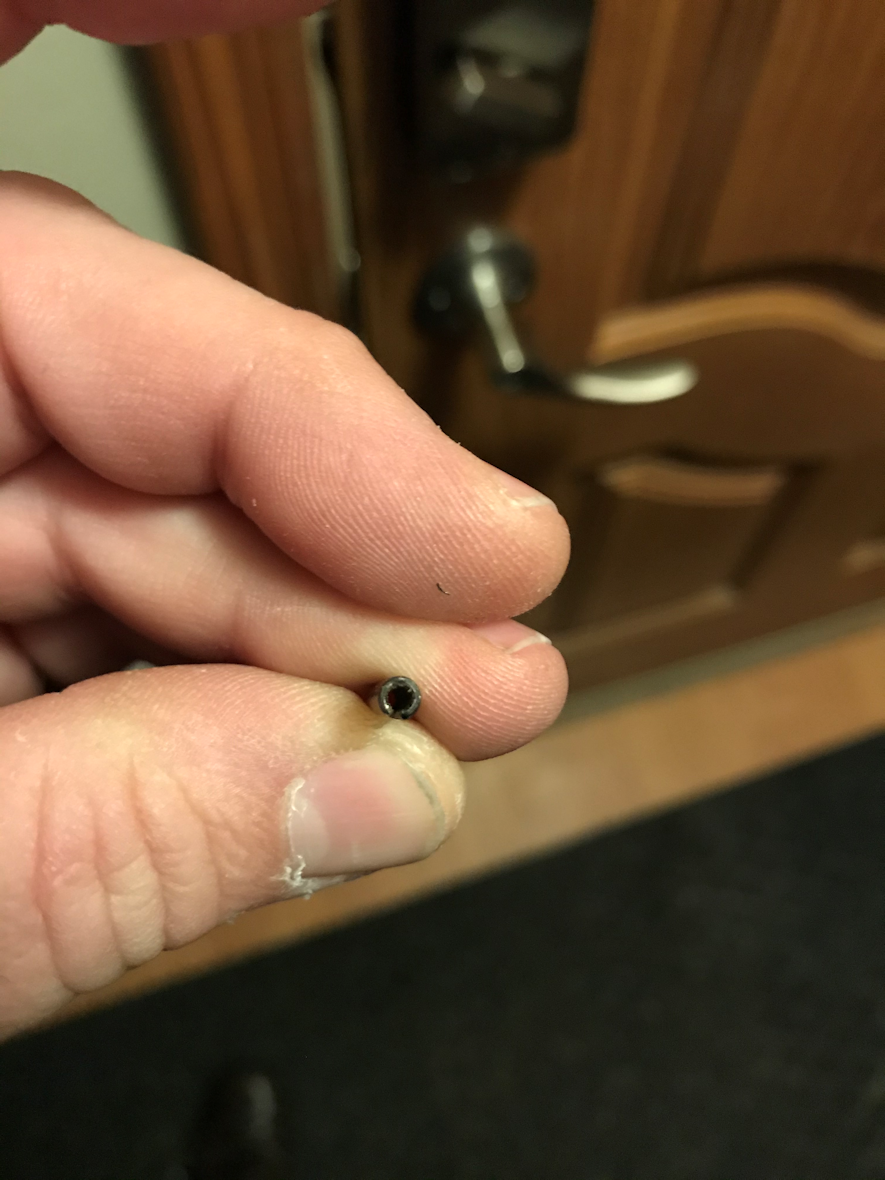

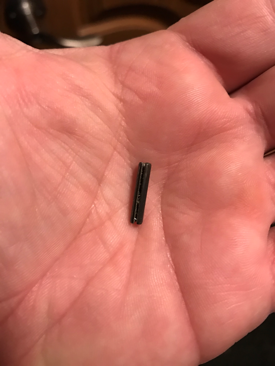

So last night I went out to the garage and poked around for a little while. I found a small screwdriver that would fit in the end where the hoop goes and I gave it a gentle pull... Nothing... I adjusted my grip and gave it a good pull... Wouldn't budge. So I pulled my hand out and let go of the screwdriver. Well the little button turned and the screwdriver fell down under the motor. I grabbed my little magnet on a string to retrieve it and on the first cast came up with this.
IMG_2544 Reduced.png (1.35 MiB) Viewed 1520 times
IMG_2545 Reduced.png (1.39 MiB) Viewed 1520 times
Any idea where this came from? And how to get it back where it belongs? Ultimately I retrieved my screwdriver and tried it again. It ain't moving. Everything spins. The sheave just doesn't move. I put some oil in the weep hole to see if that frees anything up. Any ideas or suggestions on how to get this part moving again?

There is a roll pin that holds the pork chop in place for it to rotate to move the control sheave. I can not tell if it is still in place in the pictures.

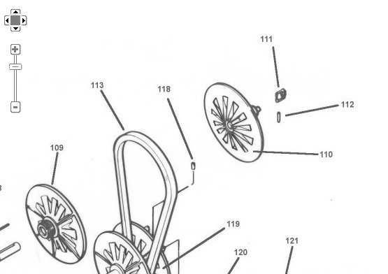

Maybe this is the rollpin that you found, i.e. on the end of the sheave. Part #112 in pic below (Shopsmith #513734).

I don't believe the roll pin is missing from holding the "pork chop" in place otherwise it wouldn't stay in position. If not what RFGuy suggests. It may have simply dropped in there at some point. Maybe a broken speed control previously that lost it and a repaired speed control replaced it.

Nope RF Guy is the winner... Roll Pin part number 112. When I discovered the retaining loop wasn't attached to the control sheave there was no roll pin . I didn't even know there was a roll pin involved until I found it and RF Guy pointed it out.

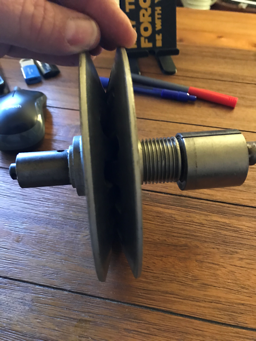

Some times they will free up just with lubrication, possibly taking more than one day and, ideally, adding some lubrication to the shaft in the drill press position, which allows gravity to assist and you can usually apply more oil. I don't personally do that. If I have one that sticks I prefer to disassemble the Idler Shaft (or motor shaft) for thorough cleaning, inspection, and possibly polishing. I don't know the history on your Shopsmith, but frequently they are bought used which often includes poorly maintained recently. Dirt and sawdust get in there and, over time, residue and/or corrosion are left. Most of the time I go ahead and do both the Control Sheave on the Idler and the Floating Sheave on the Motor at the same time.

You asked earlier re cold weather. Yes especially if the oil used is not #10 machine oil(very low viscosity)). Cold(lack of heat) tends to make sliding parts sticky. IIWM, I would remove the control sheave, clean all the existing oil off it and relubricate with #10 MACHINE oil.
The floating sheave(motor shaft) likely has a similar issue.
If you continue to need to use it in near freezing temperatures. I suggest running it a few minutes to warm things up before attempting speed changing.=

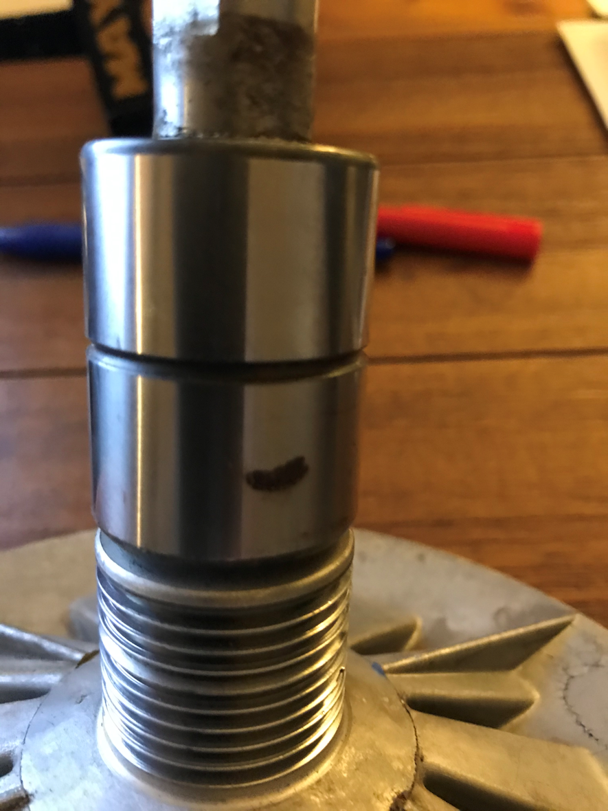

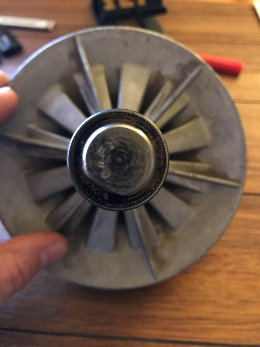

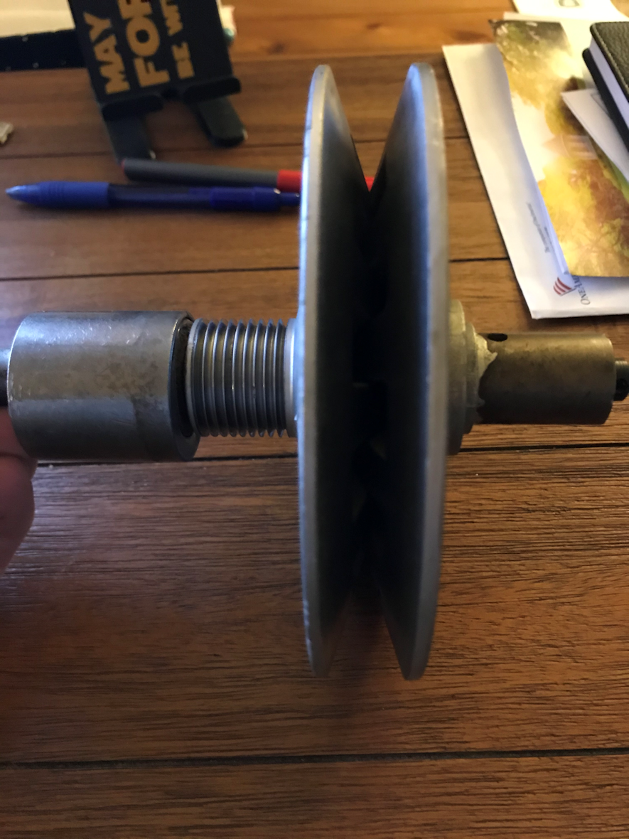

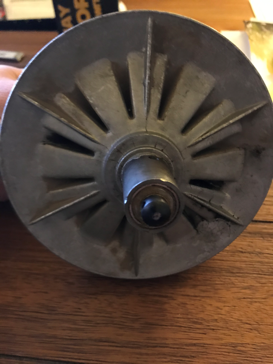

Okay... I want to stress that this thing was blown out and lubricated with zoom spout when I first got it. I cleaned and lubed everything. It came with a bandsaw and I putz around with that a few days. Cut some lumber on the table saw a few times and then life got in the way and it sat. It was working the last time I turned it off. So with that said I have per the suggestions of this forum tore down the head and removed the Idler Sheave assembly. The two halves are really stuck together. It isn't budging at all. What do I do now that I have it out of the head? I don't think I want to pry on it. Any suggestions? What has worked for others?
IMG_2578 Reduced.png (1.53 MiB) Viewed 1428 times
IMG_2579 Reduced.png (1.44 MiB) Viewed 1428 times
IMG_2580 Reduced.png (1.64 MiB) Viewed 1428 times
IMG_2581 Reduced.png (1.46 MiB) Viewed 1428 times
IMG_2582 Reduced.png (1.51 MiB) Viewed 1428 times

okay progress. I put some drops of oil in the weep hole and let it sit for a few minutes. It moved a little. So I repeated the process. After some tug of war with my son I got them a part.
