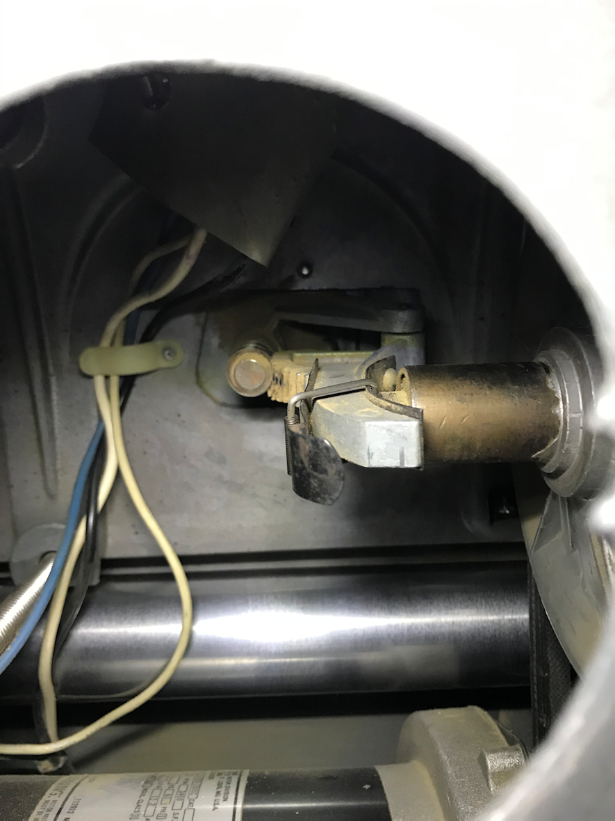

Can you take a picture through the inspection hole and post it? Likely things to look for: Does the worm gear turn in response to the speed control? (Probably yes, you said the set screw was still correct.) Is the 'pork chop' (speed control quadrant) centered on the worm gear and is it moving in response to the control? (Highest failure item in a Shopsmith, I'm told.) Are the legs that hold the pork chop straight and with minimal gaps where the roll pin that the quadrant rotates on goes through them? (This would be the likely cause if the quadrant is not centered/straight relative to the worm gear.) Finally, is the button bearing in the control sheave intact? This is where that wire retaining loop connects the speed control to the control sheave.

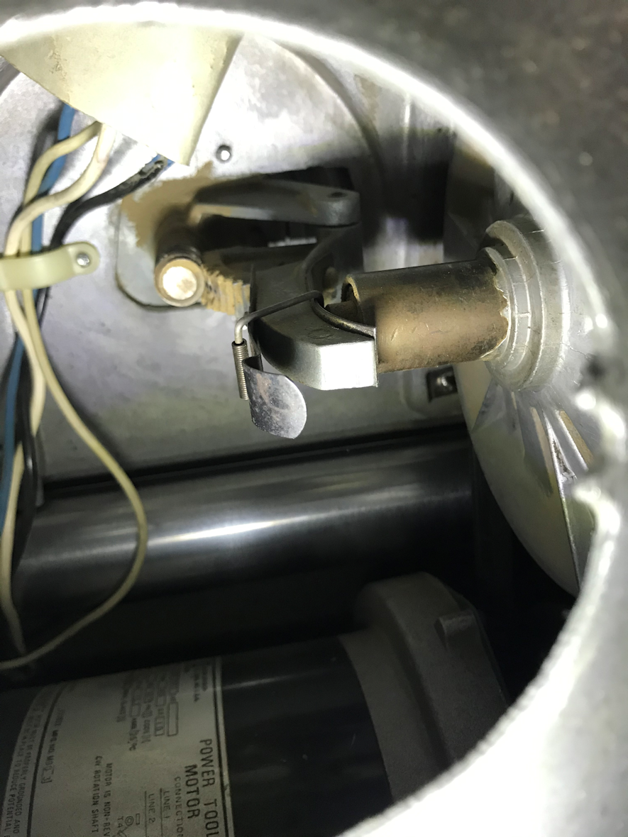

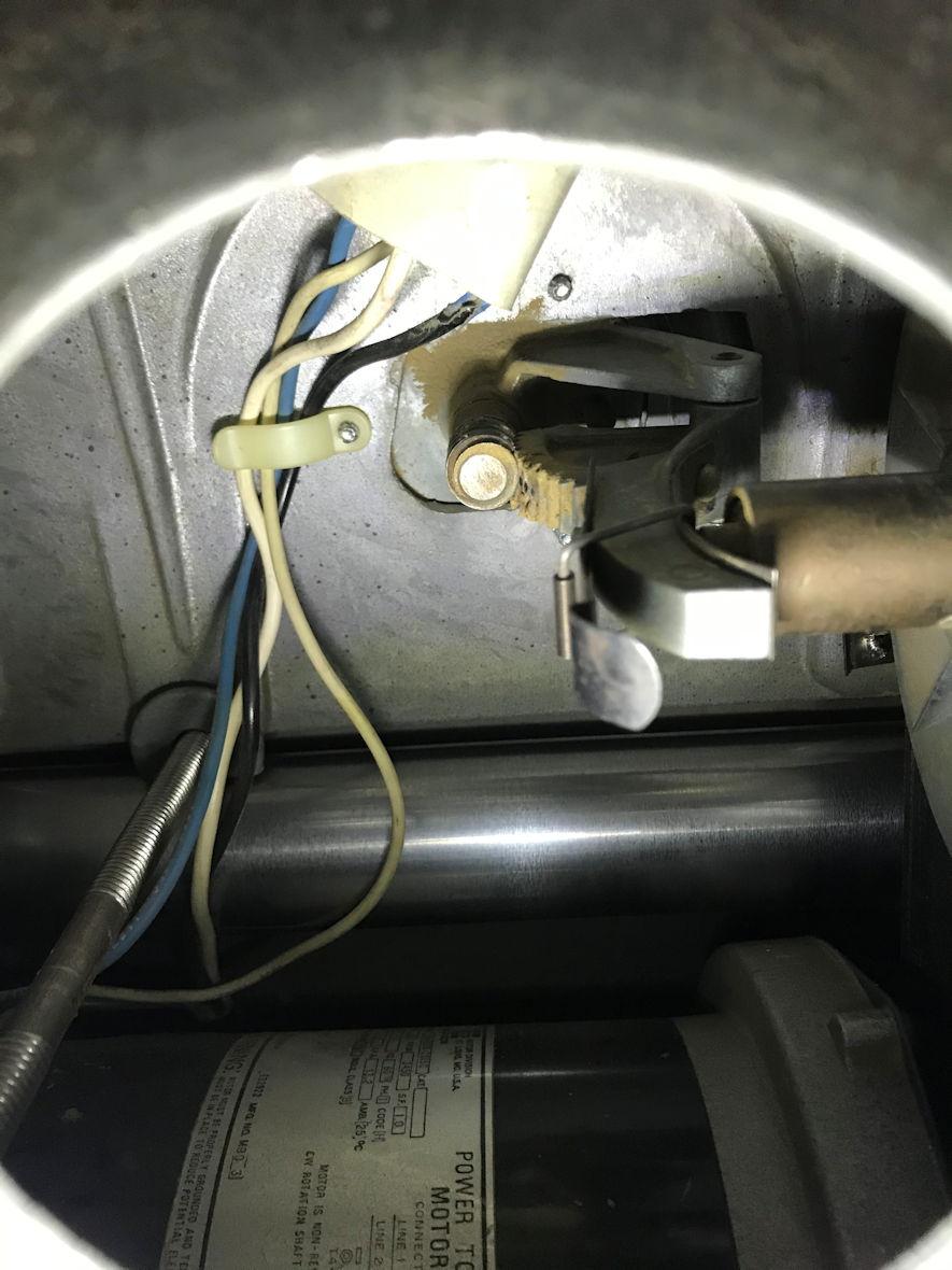

Hope these show you what you need to see.

I don't see anything obviously wrong on the speed control. Are you sure the setscrew for the speed handle is tight? There should be a recess in the shaft and the setscrew should screw down into that recess. That ensures the worm gear turns when you turn the handle. I see some spots on the quadrant (pork chop) that looks like wear, but it could just be the absence of sawdust where that part had been engaged. Quadrant looks centered and straight, and the leg we can see looks good.
If it was me I would run the motor and watch through the inspection port while increasing the speed one or two turns. You should see the worm gear turning CCW at the same rate you're turning the handle, the end of the quadrant moving to the left, and the control sheave following it to the left. If all of that is happening the speed control would seem to be working. The next step I would take is slide the belt cover off and see if the sheaves are moving in response to the speed control.
One thing to keep in mind is that speed and sound don't change very quickly at the slow speeds.
I also recommend routing those power wires away from moving parts and/or add some chaffing protection. It might be the pics, but they look very close to the wedge lock screw and to the way tubes.

So I turned it on and turned the dial. Sure enough once the worm gear moved the porkchop over some it was very apparent the hoop has disconnected from the sheave. So it is colder than a witches tit out there tonight so I'm not going to work on it now but is it as easy as reattaching that hoop and moving on with my day or is that one broken and I need a new one?
