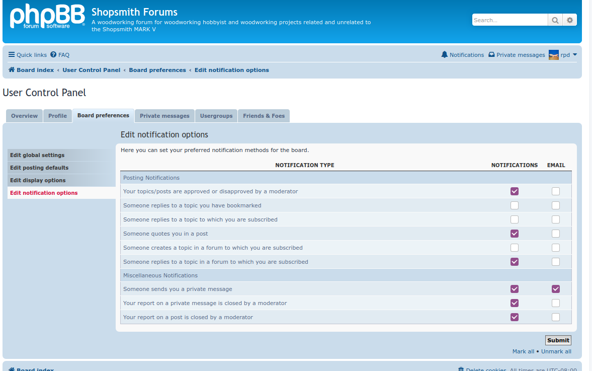

I just read everything,miken wrote: Sun Nov 29, 2020 9:56 pm P.s. I am not getting notifications when people reply. I checked all the boxes on the notifications page. What am I missing?
Mike -
but some things you could check
- when you make selections in the Control Panel, you have to click Submit (bottom right) for the changes to take effect.
- if you have notifications they are flagged at the "bell"-Notifications (upper right) click to get a drop down menu
- read the description of the notification types. with the exception of "someone quotes you in a post" the rest do not activate unless you have subscribed to the topic. To subscribe to a topic. just above the first post on a page click on the wrench icon (next to the "Post a Reply" button) and choose Subscribe Topic, or Bookmark Topic.
- unless things have changed with the new version of the phpBB software, the the screen does not automatically update when things like notifications happen, you need to refresh the screen either by using your browsers refresh button or by navigating to a new screen. Note, using the browser back button does not update the screen, it just reloads the previous screen from a cache on your computer.
- if you have selected to receive Notifications by Email, be sure you have entered your Email address in the
User Control Panel - Profile - Edit Account Settings - Email Address box.

Thank you, the notifications started working.
