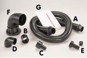

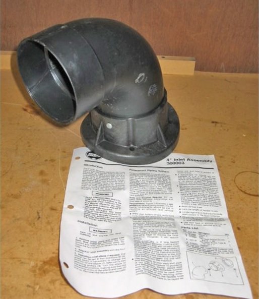

Shopsmith used to sell a 90° elbow (item "F" in pic below) for conversion to 4" ducting, but it isn't available any more unfortunately. It replaces the 3 2.5" port plenum and was Shopsmith part #300003. You can still hook up 4" PVC without it, but it is a bit more clunky.

There is a reason the 4" elbow is no longer offered. AIUI it does not work well(too low air velocity).

As Red says, the 4" adapter was discontinued as the older dust collector did not have the air flow for larger than a 3" line.
