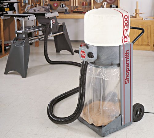

Maybe the actual Shopsmith DC-6000 Dust Collector will give better clues. The picture in the new catalog is a cropped and edited one of the DC-3300 from the online catalog.
