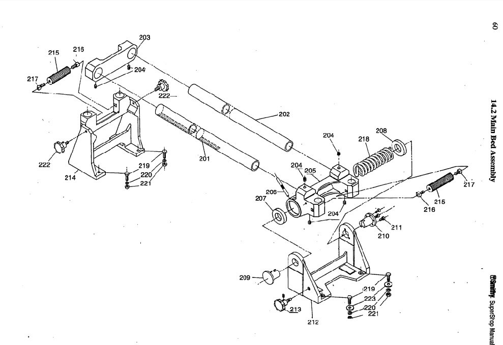

Thanks Ron. That's an interesting idea and I hadn't seen that pancake style torsion spring before. It might be an option for me to incorporate and still keep my 3 cabinets under my Mark V. Definitely interesting and thanks for posting it. I did go and dig up the exploded parts diagram for the Smithy Supershop and it is what I thought, i.e. a cylindrical torsion spring (similar to garage door) is mounted inside the base casting. I don't have a PowerPro headstock, so any lift assist could be worth it, i.e. it doesn't have to offset all of the headstock weight.

Thanks for that drawing. I was not able to envision how a garage door spring would work. I also can not imagine how you would incorporate such a spring without redesigning the Base Arm casting. Not a DIY job.

dusty wrote: Tue Feb 02, 2021 1:13 pm Thanks for that drawing. I was not able to envision how a garage door spring would work. I also can not imagine how you would incorporate such a spring without redesigning the Base Arm casting. Not a DIY job.
Dusty,
Yeah, the garage door type spring wouldn't work on a Mark V without a major re-design of the base castings, etc. This may not work, but the idea that I have is to use 1 or 2 of the spiral torsion springs like Ron posted a link for. Idea would be to mount it outside the base casting, e.g. in front or back or both. I have been meaning to build some mounts that hang the 3 red Shopsmith cabinets under my Mark V so that they are always there and move with it when I need to roll it around. I may be able to incorporate these spiral torsion springs in some manner with this mount and attach the other side to the bench tubes. If this would work, I would probably need some way to lock it when down so that the spring tension doesn't inadvertently affect my Mark V alignment.
