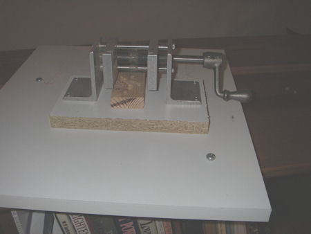

fjimp wrote:Okay here are the promised pictures. The first shows the top side of the vice mounted on the jig I built for it. I learned the hard way that if the vice isn't totally stable it twists and moves.
The second picture shows how the vice is bolted to the jig. Secondly how even ugly mistakes can be corrected and finally make a useable jig. Finally how four t-nuts properly located with phillips head screws from the top side create a totally stable drilling jig. Once I got the table the way I wanted it I used a marker to show where the jig needs to be located on the table so it is automattically centered every time I use it. Incidentally I also use adjustble legs to keep the front corners of the table steady while in drill press mode and a bottle jack to steady the rear of the table. Yes I am picky I don't enjoy wasting even a single pen blank nor do I like to do anything over. fjimp

Okay I will try the pictures again. Sorry fjimp
Pen Vice Jig.JPG (17.57 KiB) Viewed 9126 times

fjimp
Posts: 2345
Location: Lakewood, Colorado
Post by fjimp »
cdlowboy,
Good luck with pen turning. It is a rewarding hobby that allows a great deal of creativity.
I checked the Deluxe Pen Drilling vice you referred to. It comes closer to the real thing than any other I have used except for the vices built by Paul Huffman of Oklahoma City, his is far superior to any other I have tried that really works. If you try this one you found I would make one suggestion. Create a very sold base for it to attach to. If that base is close to the full size of your drill press table and well attached to it you will have better luck than with most other vice arrangements. fjimp
