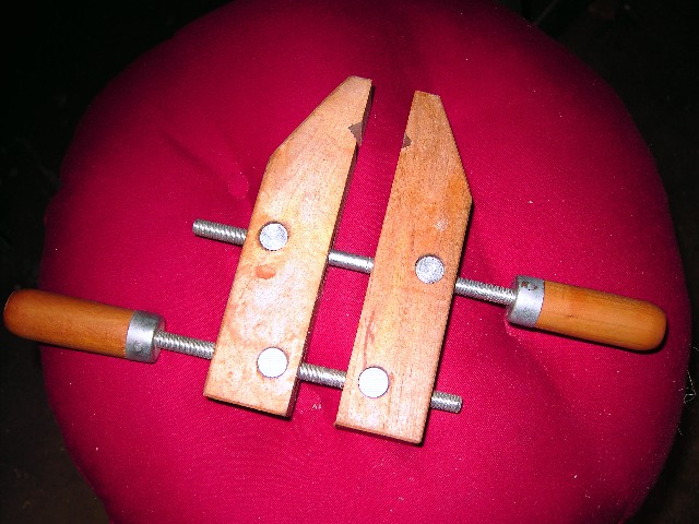

I use a very, high tech method to drill my pen blanks....
Pen Clamp.jpg (89.56 KiB) Viewed 10392 times
George
Ft. Worth, TX.
Go TCU Froggies
