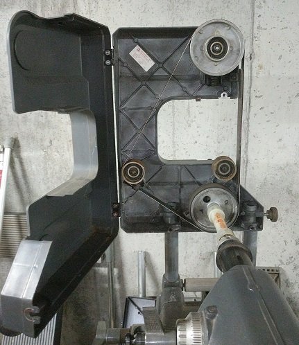

Ok, so re-assembled the Strip Sander (except for the table) and mounted it on the right side of a machine. There is no hole in the door yet for the shaft to extend through so the door is just open. I put in a belt and can run it, the belt tracks, everything seems fine so far.
I ground a flat into the left side of the shaft to mount a hub as close to the drive wheel as possible because there's no bearing supporting the shaft on that side. I'll have to work out the exactly where to locate the hub.
One might think the shaft would line up right in the middle of the Shopsmith label on the lower part of the door, but it doesn't. It's near the edge of that circular indentation at the 2 o'clock position. I may have to cut out that whole circular indentation to work out a clean hole for the coupler to pass through.
This is the proof of concept. I have to clean some the parts still, mount the table, and work out that hole in the door, but I'm pleased with what I did so far. Rarely do things work out this well. I tried to post all this before, but it disappeared on me. Keep an eye out for a similar post in some other thread.

DLB wrote: Wed Apr 07, 2021 2:13 pm Very nice Ed. How much do you intend to cut the tubes for this sanding shorty? Will it have a main table? Do you intend to mount anything to the Strip Sander at the traditional drive shaft location?
- David
Responding again now that I had a chance to set it up and measure. WIth the Strip Sander on the right, the Belt Sander on the left, and a 500 main table mounted I can cut off at least 12". The main table could run into the Strip Sander table at it's height, but that height is unlikely to be used with a sanding disk, and certainly too high for a drum. The dust collector port for the Strip Sander sticks out the left side of the sander and could interfere slightly with the main table at a much lower table height. Ignoring those two unlikely problems I can take 14" off the tubes. I still have the option of reducing the main table size and could remove at least another 2" simply by cutting a 500 table, more from making a custom table top.
If I want to use the disk sander on anything of substantial size I can always remove the Strip Sander. It is very light compared to the Belt Sander so that is another advantage to mounting it on the right side. I suppose I could also use those funny offset SPT tubes for the bandsaw to shift the Strip Sander to the right and pick up another inch of space for the main table, but that wouldn't reduce the overall footprint.
