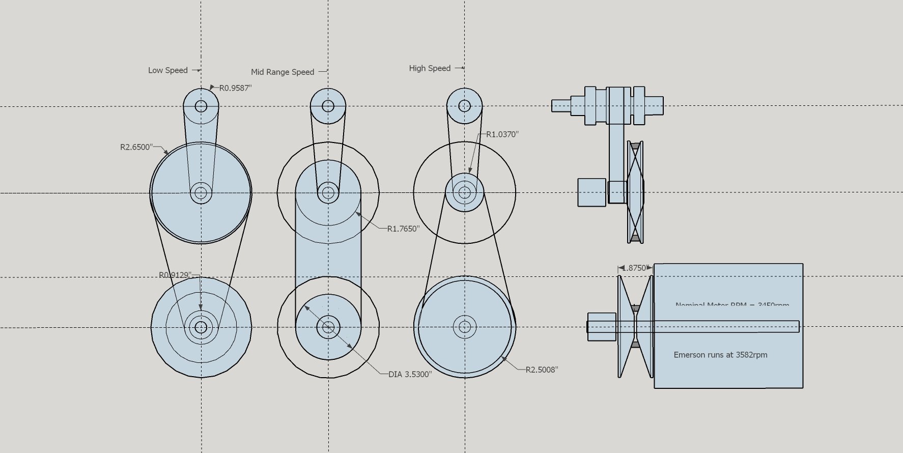

Re: Idler shaft extremely hot
The MarkV Sheaves Revisited.jpg (142.24 KiB) Viewed 849 times
A visual: The numbers are empirical as they represent my machine at a point in time. It is probable that the same data will not exist if collected elsewhere but they should be close.
