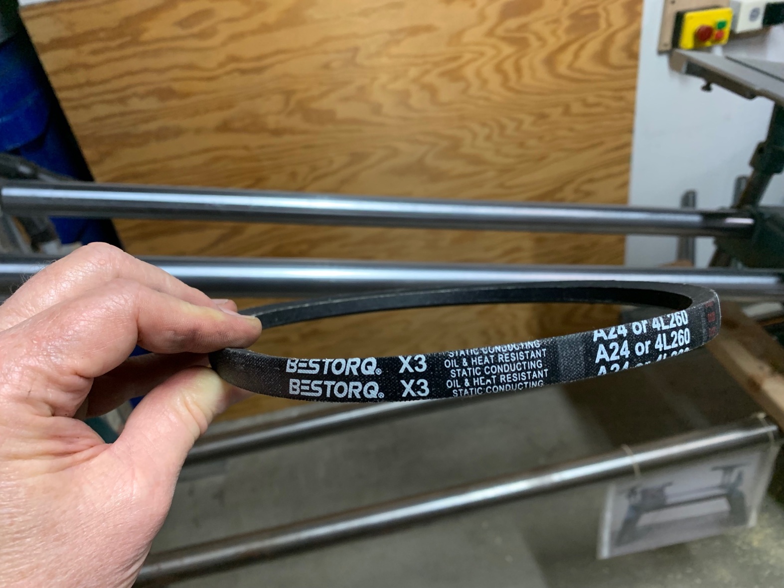

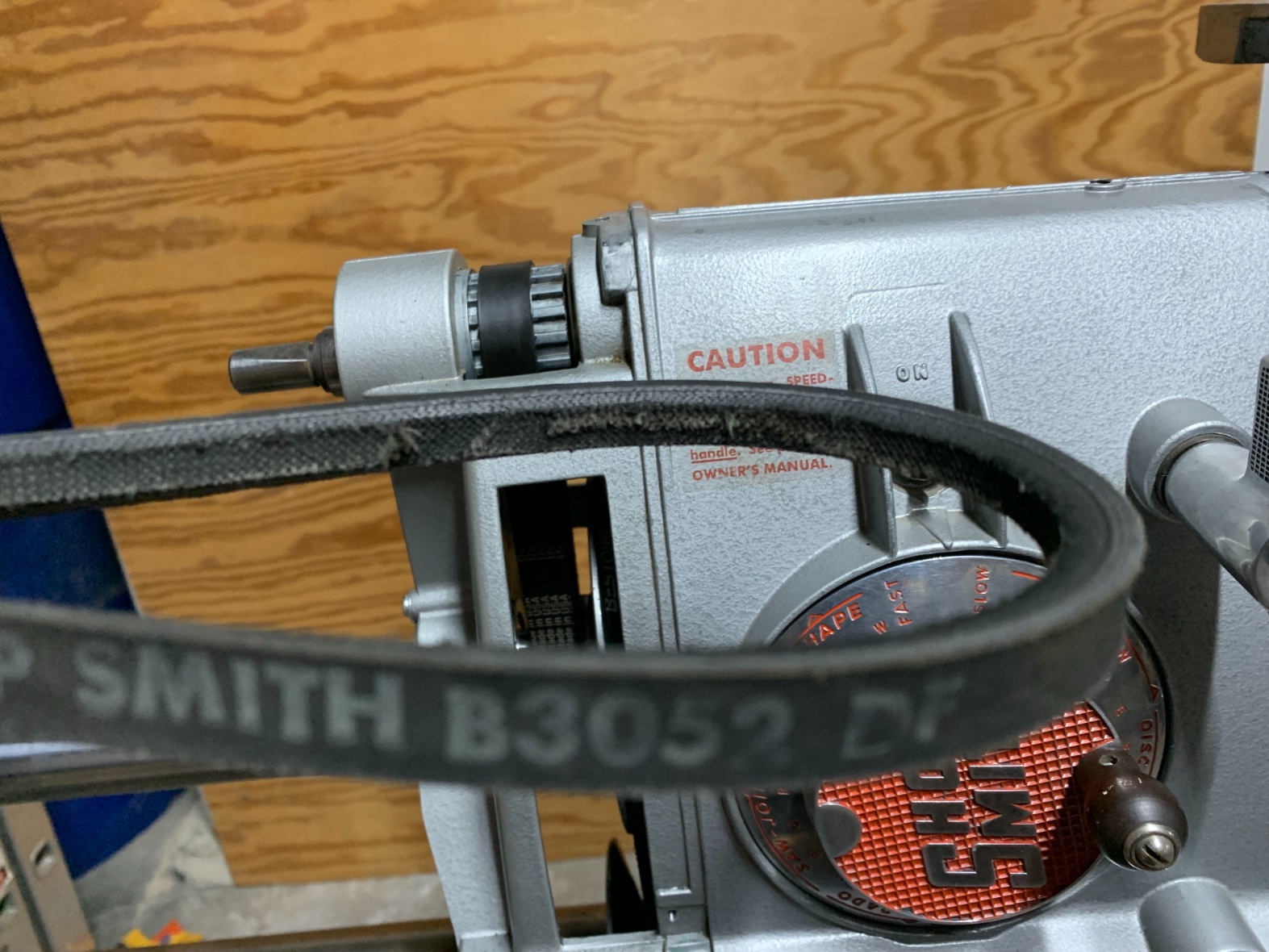

Yesterday I received a new idler shaft with dual pulleys on it, which meant I had to replace the eccentric bushing too. I also replaced my old drive belt with a new ShopSmith belt. After I got everything back together this evening I powered it up at Slow and let it run for a few minutes, just listening to it. It was quiet. Powered it off and, although it’s a little harder to turn manually, which I attribute to the new belt, everything appeared to be fine, so I started it up again. I slowly ran it up to “R” and then back down to slow, pausing to listen to it at a few points along the way. The continuous run time was about 5 minutes. After turning it off, I found I was able to grab the exposed idler shaft and hold on to it. Yes it was hot, but before I changed the shaft I couldn’t touch that shaft for more than a couple of seconds.
Did I say it runs a lot quieter? It’s not as quiet as my 10ER, but certainly better than before. This makes me very happy. I’m ready to make some sawdust! :D
Here’s a look at my old and new belts.
Old drive belt, a little frayed.
New drive belt, a little shorter (not stretched)
Marc Jones
Re: Idler shaft extremely hot
Yes, less frayed(and a bit shorter and a bit narrower).
Short causes it to run slower.
Narrow causes it to run faster.
Narrow can cause it to jam quicker.
Suggest you get the SS version.
It 'should' be 26 1/2" and a bit over 1/2".

As I know you’ve seen in my post on the “Belts” thread, I did get this belt from SS, and it is slightly narrower than 1/2”. My measurement was after it was installed and had run for 5 minutes. I didn’t think to get measurements until after I read the previous discussion on getting a SS belt, and by then I had already installed it. I suppose that running it a bit and how tight it is since it is shorter could have some effect on width. I would expect the effect to be very minimal, but I don’t know what that means in terms of physical characteristics.
