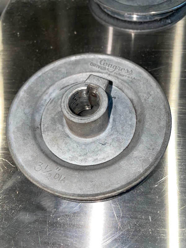

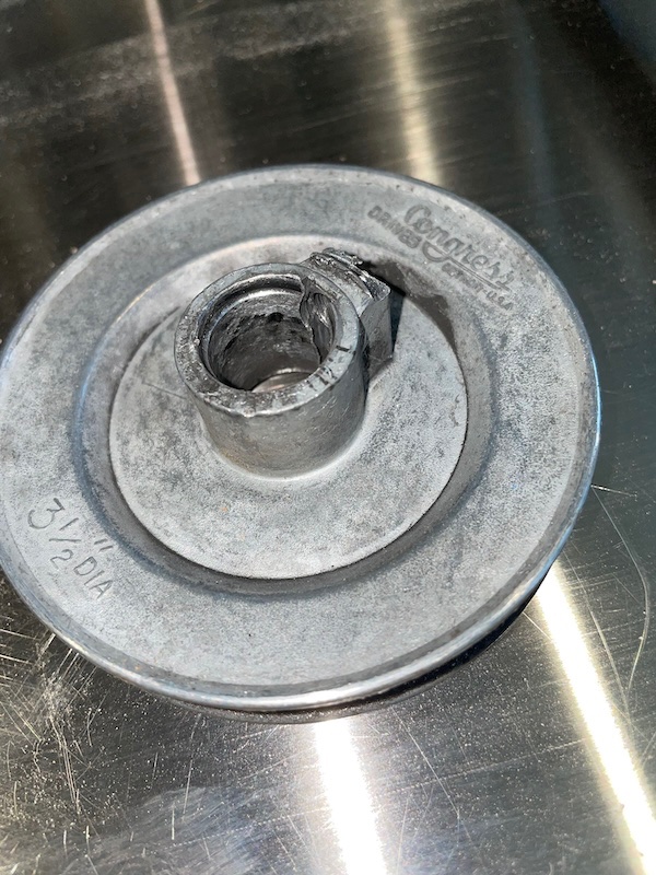

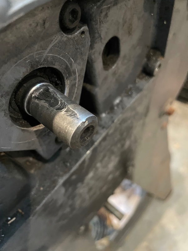

Reviving this old topic to ask about MV planer pulleys. I have a MV planer on a shopsmith stand (not pro planer). It is powered by a 1 1/2 hp AO Smith 3450 RPM. I have used it lightly but the last use gave a wrong noise that inspection showed was due to the cutter pulley having shifted on the shaft. The shaft appears to be the tapered shaft (5/8"?) similar to that on th e headstock quill output, and the pulley was anchored with 5/32" allen. The pulley seems to have a shim to fit the shaft? or some kind of split bushing? The cutter shaft taper was messed up and I used a file to take of the high points and tried to maintain the tapered flat.
The motor pulley has a woodruff key slot but was only held by a 5/32" allen that dipped into the slot without a key present. None of this sounds right. Both pulleys are 3.5" giving the cutter head 3450 rpm.
So I need to replace the cutter head pulley. Am I right that any pulley for a 5/8" shaft with a thread for 5/32" will work? (Using blue loctite on that allen screw). The clearance between the set screw on the widest part of the taper and the frame of the stand make access for tightening pretty difficult. Other solutions to firmly attach the cutter pulley to the tapered shaft?
Can I reduce the cutter pulley diameter to improve performance? Any suggestions on how to rectify this and improve on the set up is appreciated.

First recommendation I would make is get cast iron pulleys. Grainger has some reasonably priced ones. Likely from China. They look good to me.
Over the years I have attempted to use aluminum pulleys even for low load fans with less than acceptable longterm results.
As for changing pulley size to 'improve performance", that job belongs to the motor. Reducing pulley size increases load on motor.
P.S. I would use a cup point set screw with shim in pulley key groove to prevent marring planer shaft .

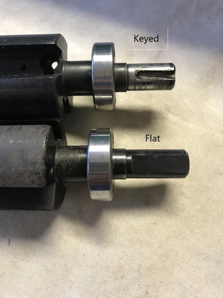

The pulleys you are likely to find are going to be the key type. Since your Planer is, as you said, originally a Mark Mount Planer converted to a stand like the Pro Planer it was then set up to use a pulley instead of the Power Coupler and Hub on that shaft. After the Pro Planer was introduced the end of the cutterhead shaft changed to have a key on one side and a flat for a Power Coupler Hub on the other side. See picture below. With that both the Mark Mount and Pro Planer used the same Cutterhead assembly.

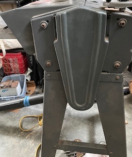

I should think before I post: The pulley guard on my stand will not accept a 5" pulley at the motor end, only at the cutterhead (which doesn't make much sense). So I I either need a different pulley guard or I stick with a 3.5 in pulley on the motor. I have pulley guard kits 513552 but these cannot be attached to the planer stand. Attached is a picture of of my guard.
