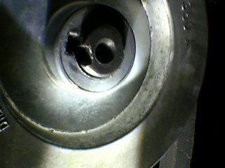

This may or may not be related, but after shutting things back down, I noticed this part on the shelf below the planer. It's about an inch long, 1/8 or so in diameter and looks like it may have had a set screw tightened against it. I looked at the exploded parts diagram but nothing stands out.

It have a 'flat'(full length)?
I think examining what may be now 'loose' in either the table or the cutter head is where the cause may be. I do not think that pin came from the PP.

The picture isn't the greatest, the piece is rectangular shaped, all "flat". Toward one end, it's tough to tell if it is slightly shaped or been deformed.

Could that 'pin' be a "key" off the motor shaft/pulley? OR cutter pulley.

You got it! It's the "key" off of the cutter pulley. Now to order a new one and try to get the "key holes" lined back up.

The noticeable knife marks, almost gouges, and noise was likely the pulley slipping on the cutter shaft after the key came out. A new key can either be ordered from SS or check you local hardware store.
