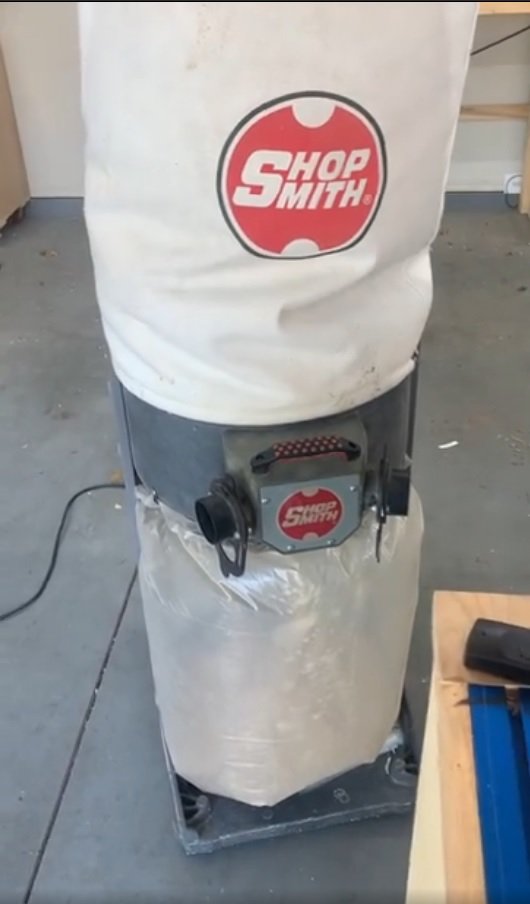

RFGuy wrote: Sun Aug 29, 2021 2:00 pm I still wonder how much more airflow, if any, this upgrade gives over the original blower design. I saw a video on FB for someone who did the upgrade, but the 42" filter hood didn't inflate anymore than my DC-3300 does, i.e. it doesn't fully inflate like it should leaving part of the filter hood collapsed (see video at link below). In fact, I think my stock DC-3300 inflates the 42" filter hood more than shown in this video:
https://www.facebook.com/9601686/videos ... 4104333129
I can't view the video for comparison to mine. I get a FB message indicating the content is not available. It's a great question, perhaps better in the tool review thread. (But I don't think perspective buyers are likely to read a 30 page tool review either. ;) ) I Don't know of anyone planning to do an objective review with correct instrumentation.

You have to be a member of the Shopsmith Owner's Group on FB to view the video...below is a still shot taken from the video after the DC-3300 was turned on and up to speed.

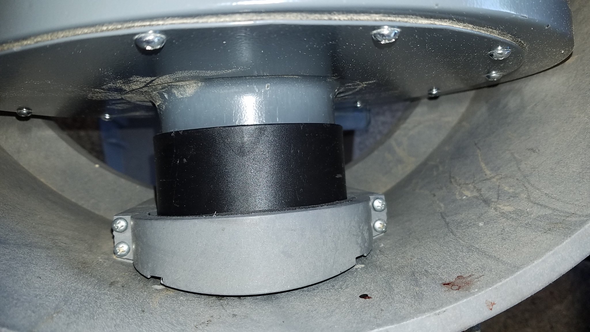

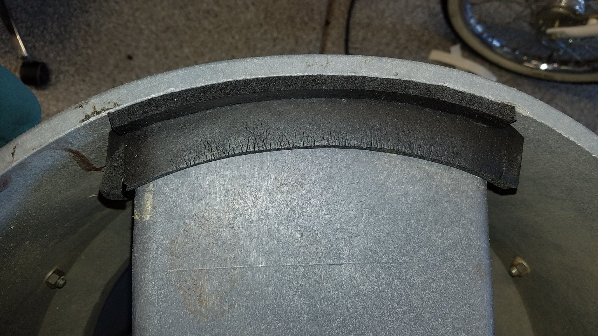

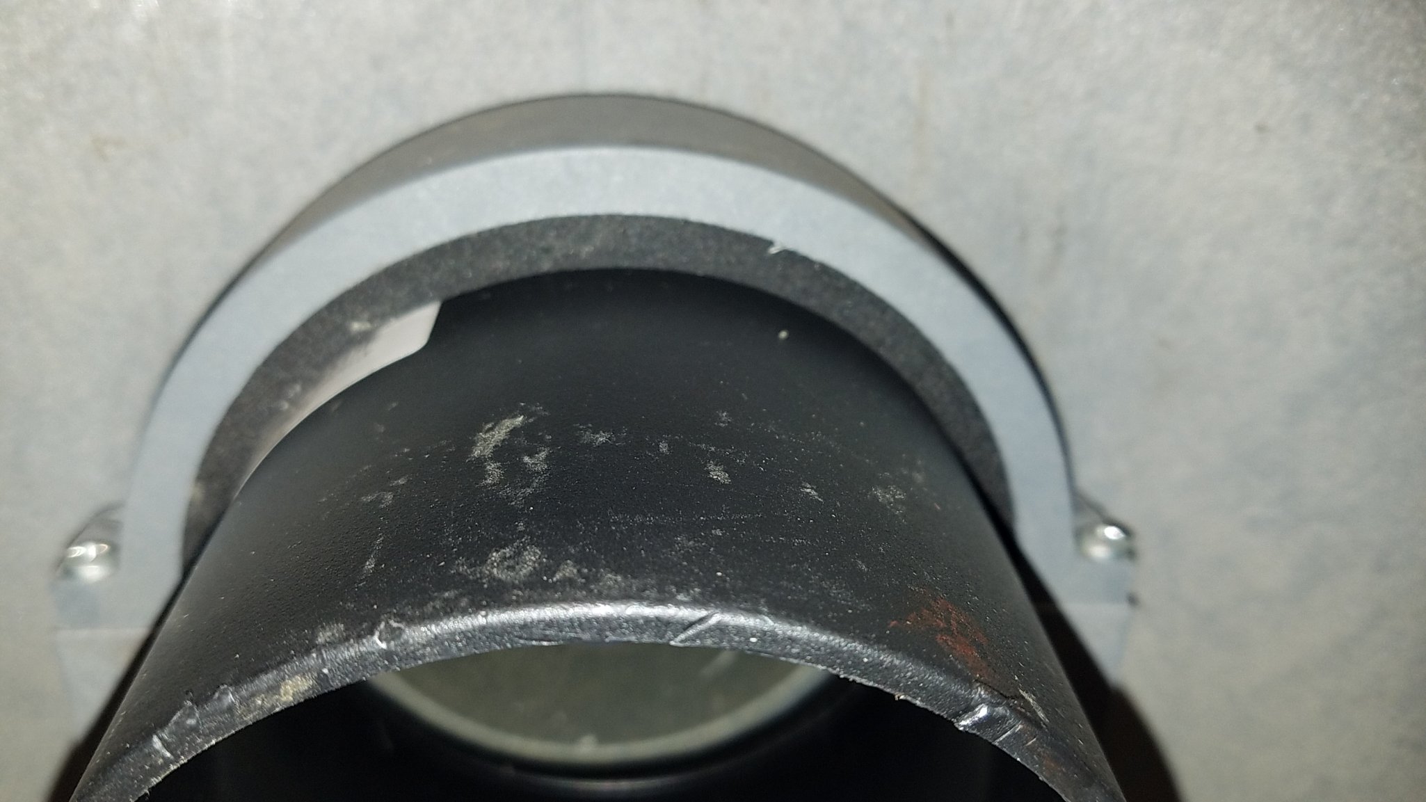

Re: Re-gasketing the Dust Collector
Got her done. If there are any leaks left they are small ones. I'll have to make a bag full of saw dust and then check to know for sure.
I sealed leaks even where I don't believe there here any.
I still had the large gaping hole across the top of the Motor Housing but it is now effectively sealed.
I mounted the 4" coupler tightly to the Manifold then installed it AFTER I had Mounted the Motor and Fan Housings. This was a lot easier than trying to work the entire assembly into the top of the DC. It also gives me a much better connection of the coupler to the Manifold (eliminates a leak potential).
It might improve things if the coupler was 5" long (maybe 4 1/2) but it ain't. If it leaks. I'll tape it where it interfaces with the Fan Housing.

RFGuy wrote: Sun Aug 29, 2021 2:50 pm You have to be a member of the Shopsmith Owner's Group on FB to view the video...below is a still shot taken from the video after the DC-3300 was turned on and up to speed.
That does not look right to me, but I don't have any photos of mine when it was assembled and 'working.' Are those blast gates open? I'd be thinking: bigger leak than I had between + pressure and atmospheric, or a pretty big recirculation leak between + and - pressure, issue with motor performance, etc.

DLB wrote: Sun Aug 29, 2021 6:18 pm That does not look right to me, but I don't have any photos of mine when it was assembled and 'working.' Are those blast gates open? I'd be thinking: bigger leak than I had between + pressure and atmospheric, or a pretty big recirculation leak between + and - pressure, issue with motor performance, etc.

Yeah, that was my initial thought as well, which is why I think the issues that you and Dusty have brought up here about the upgrade are so valuable. Unfortunately, I think only a handful of people purchased this upgrade, or the new DC-6000, so until it becomes more popular it may be difficult to validate your findings because the sample size is so small.
