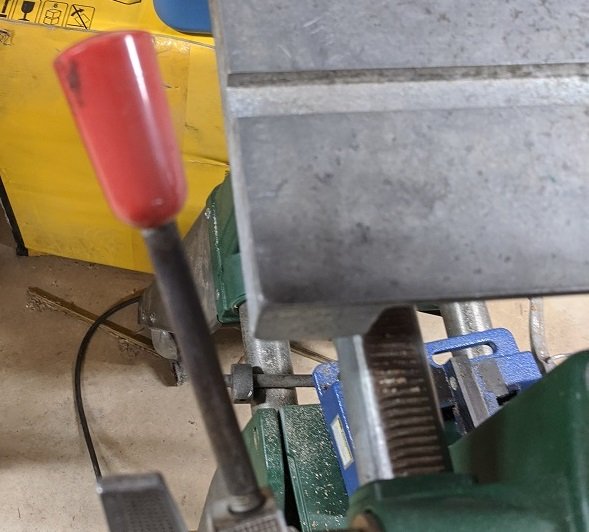

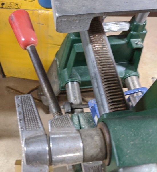

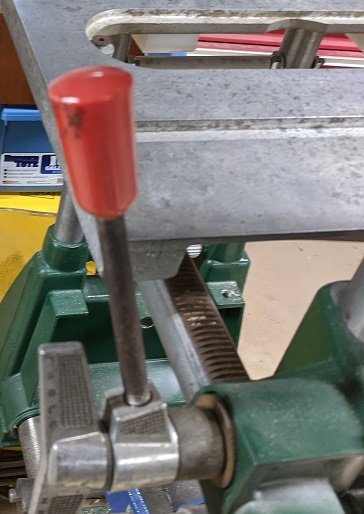

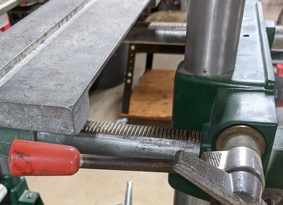

edma194
Posts: 2205
Re: Old saw table on newer carriage?
Post by edma194 »
handle 1.jpg (37.35 KiB) Viewed 981 times
handle 2.jpg (53.93 KiB) Viewed 981 times
handle 3.jpg (51.67 KiB) Viewed 981 times
handle 4.jpg (52.55 KiB) Viewed 981 times
Ed from Rhode Island
Yer table and carriage and crank shaft are bass ackwards which also places the lever etc. on the 'backside' of the table. i.e. shorty drill press???
edma194
Posts: 2205
Post by edma194 »
Yes, shorty drill press.
That explains the divergence of our comments.
