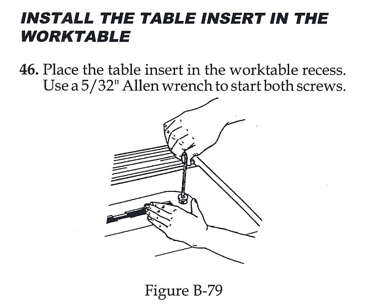

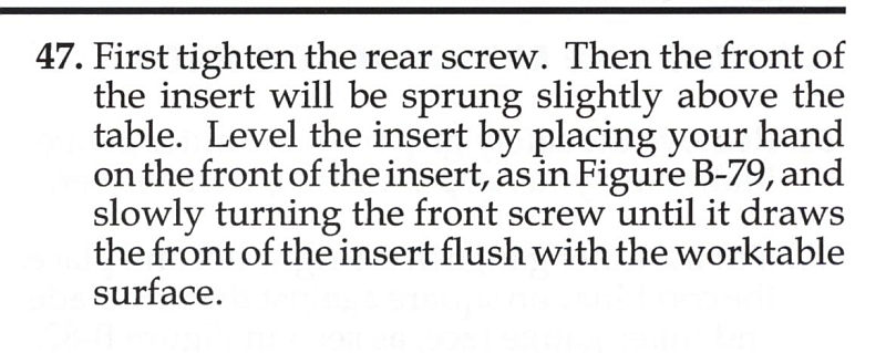

When mounted the screws are not tightened to take all the bow out. You adjust the front screw so the front of the insert is flush with the table like right on to maybe just below the surface by a hair or half a hair. Just make sure it is level with or below the main table or the wood might catch.
I sure hope they don't kick me out of here for this but since this is educational I think they will not mind me posting this out of the instructions:
[ATTACH]2596[/ATTACH]
[ATTACH]2597[/ATTACH]

- inst 1.jpg (116.89 KiB) Viewed 12498 times
- inst 2.jpg (143.11 KiB) Viewed 12501 times
