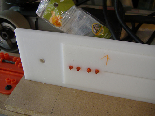

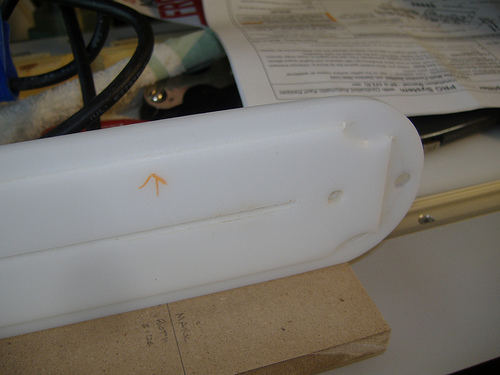

When I use to make inserts I had material that was 1/4" thick, now I'm having trouble finding things that have not been downsized. I really like to have tempered hardboard finished on both sides but no big box stores around here are selling that anymore... I'll guess I have to expand my shopping radius.
Anyway if you can find real 1/4" or just over material that works fine. When I was doing my last couple I went to some UHMW plastic and had to size it down like can be seen here:
[ATTACH]2594[/ATTACH]
[ATTACH]2595[/ATTACH]
As it turned out I was on the money but if it got to thin I would have had to use tape or something to level it... of course you can't leave it high so be it skill or luck they don't always come out right on.
