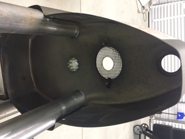

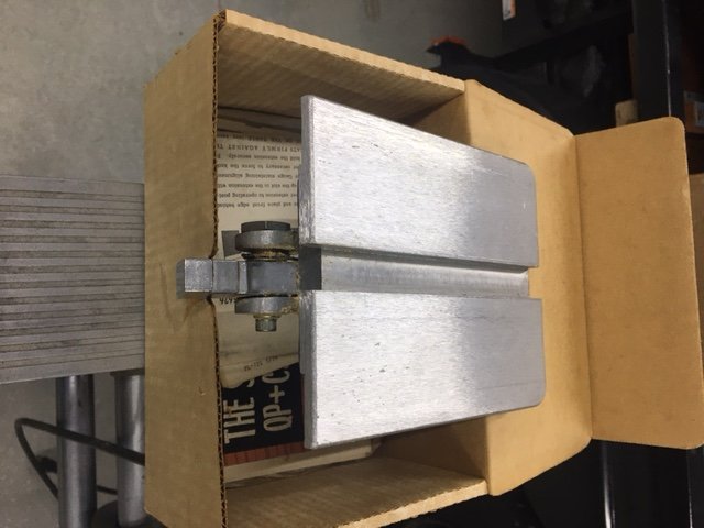

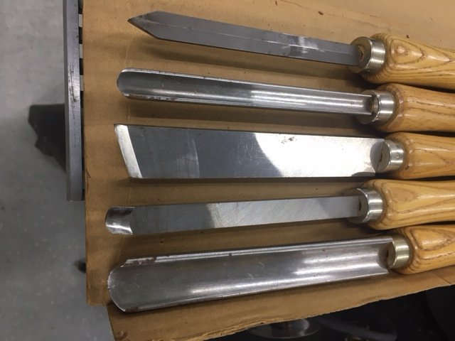

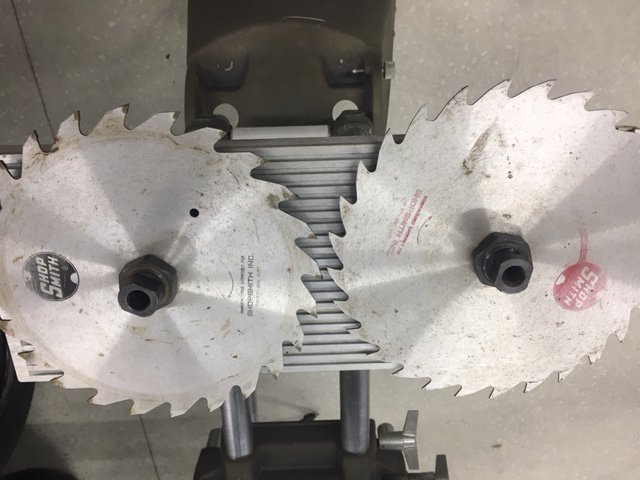

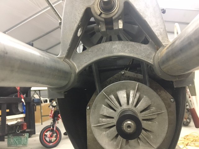

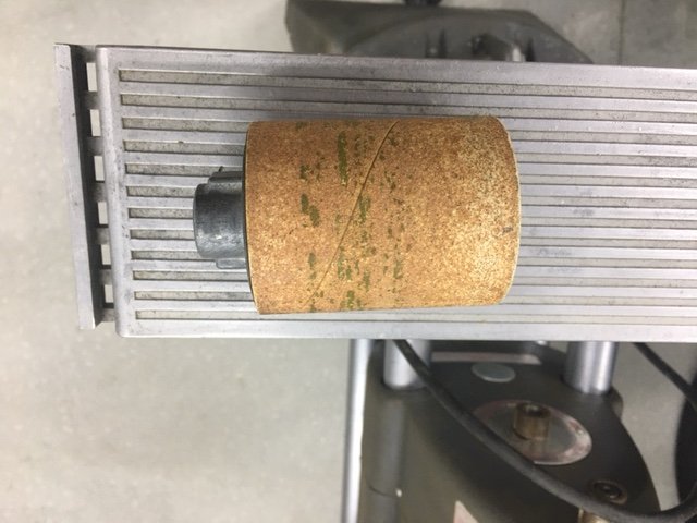

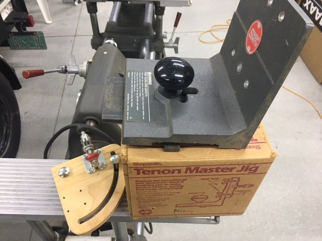

I did some clean up today. I opened up the belt cover and excess hole and I took photos of it as I saw before doing any cleaning. I think who owned it took very good care of it. It has been stored up for many years. I did lubricate both Sheaves and put powdered graphite on the speed shaft/gear. Powered it up and it ran like a clock. Also, the speed adjustment was smooth. I took some photos of the attachments that came with it. Sorry for all the photos!!

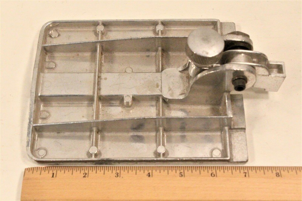

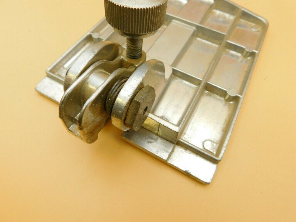

Can you tell me what this part is??
- IMG_2188.JPG (56.71 KiB) Viewed 20768 times
Re: Obtained a Shopsmith
Looks like the hold down from the old style miter gauge. You have the new style on the miter gauge in the picture up top.
