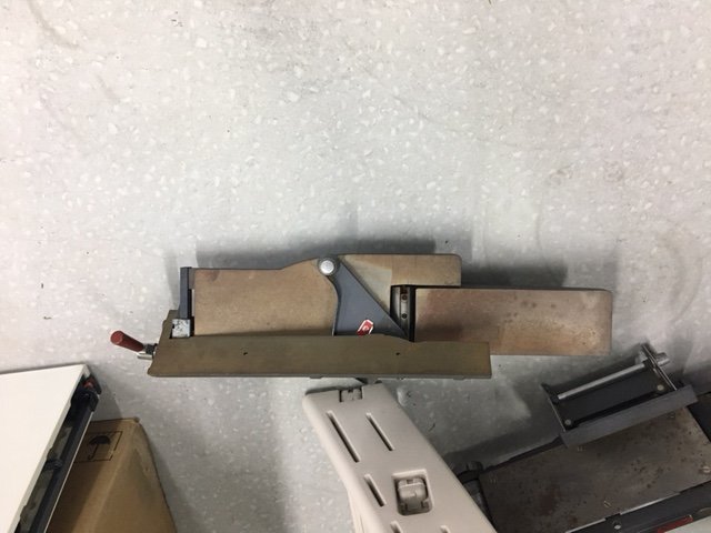

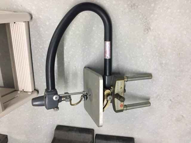

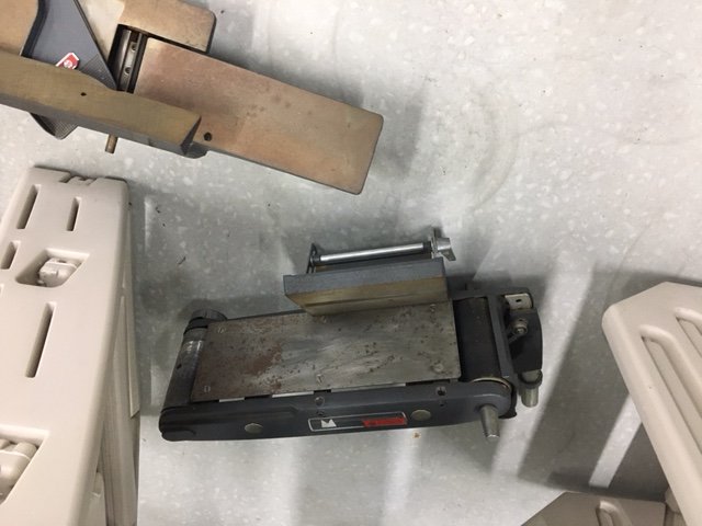

Hello all!!! I obtained a Shopsmith a couple of days ago. According to the serial# (SS 12664) it is around a 76/77ish model. It came with several attachments to include Jointer, Jigsaw and belt sander. It came with other items such as the biscuit cutter with several biscuits and mortise and tenon jigs in the original boxes and lathe chisels (never been used). Lots of other items in a large box. I am the third owner, but it looks like it has not seen much action in the past. Not a bad deal I think for 500 with all the extras. I do know I will have to purchase a power coupler (Have the hubs), a drill chuck and some of the lathe centers. My first step will be maintenance and alignment. I did run the machine and it was smooth during testing. I am not new to woodworking and have several other standalone tools but always wanted a Shopsmith. Any words of advice or tips would be greatly appreciated. Thanks
