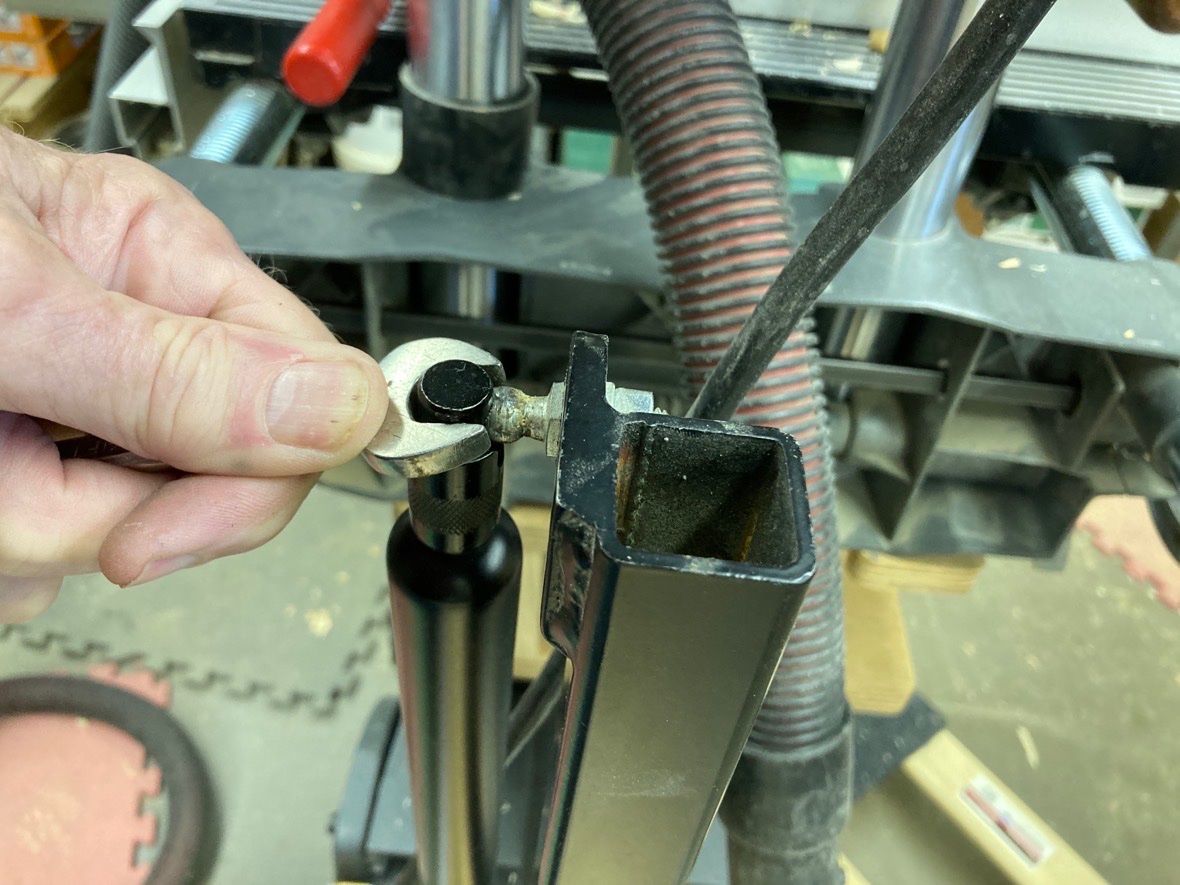

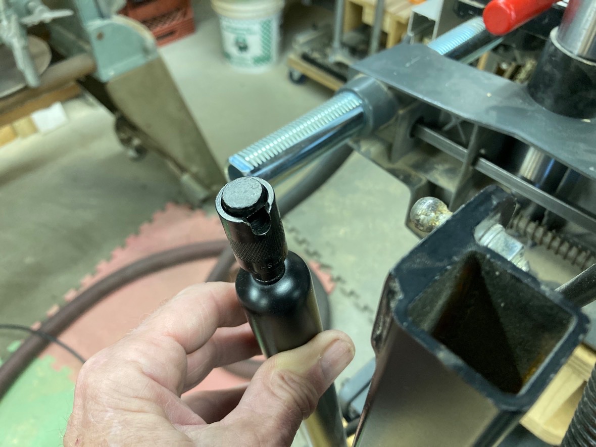

Well you beat me with the pics :D . Some days my fingers won’t grip and push the quick release so I use a wrench for extra push. You do disconnect it while it’s fully extended and in drill press mode? I slide everything to the right, tip up to drill press mode and disconnect or reconnect.
Re: Double Tilt Upgrade from Lowes
Posted: Thu Jun 15, 2023 4:22 pm
by bainin
Thanks Larry - I havent tried the wrench method- next time I'll give that a try !
b
