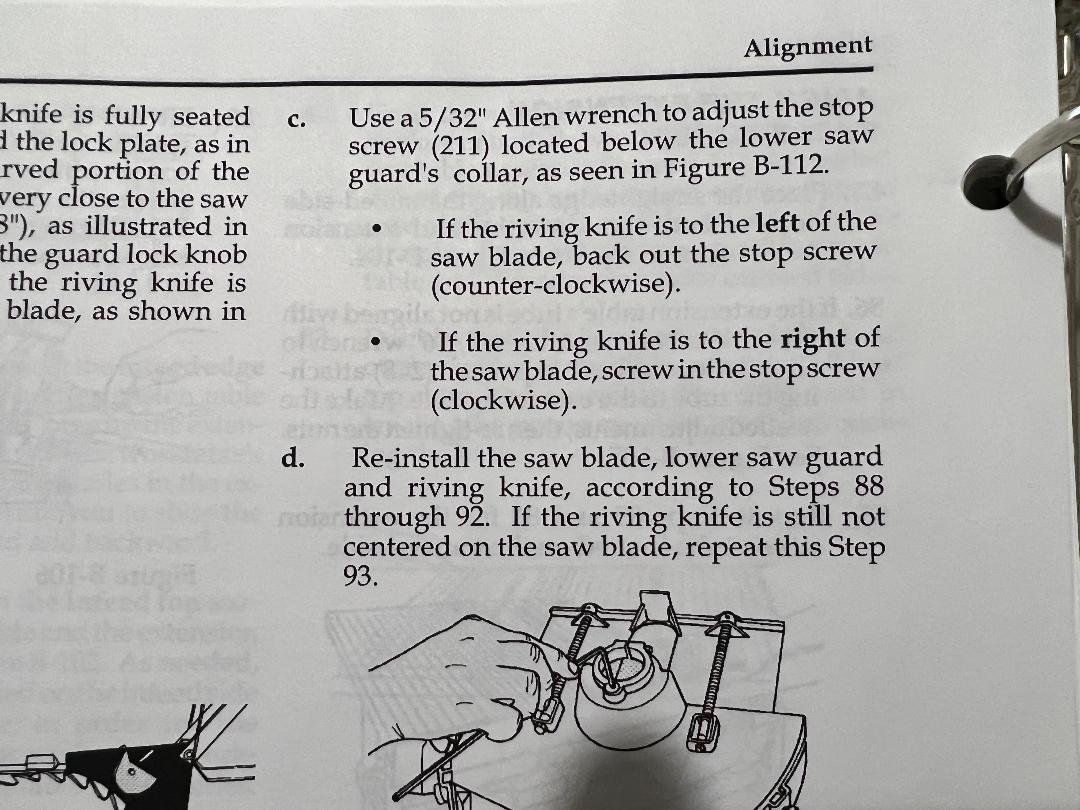

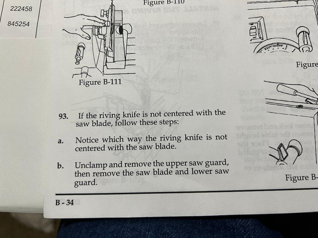

When in doubt look at the manual:

Ok, as others have suggested already, don't do that. I don't know where he got that idea from. Get your spindle knob back on properly and use the proper adjustment method. And keep your arbor mounted all the way on the spindle up to the spindle knob. If it's not all the way on it can shift towards the spindle knob when running which can cause all sorts of destruction in table saw mode. The spindle 'flat is sloped to prevent arbors from shifting away from the headstock but won't stop them from shifting toward it.

Anyone can put anything out there in the web universe. Some may think they have a better way to do something. This one is not the case. Important things to remember here are the locations on the spindle where the set screws go for both the Spindle Knob and attachments (arbors, chucks & etc.) are reverse tapered flats. Moving either the Spindle Knob or attachments away from the Headstock and "locking" them down leaves them able to move back toward the Headstock during operations. This can cause poor results and dangerous conditions. Using the Spindle Knob to "adjust" the blade position relative to the splitter of the upper guard is not the way to do it. That is what the adjustment screw on the lower Blade Guard is for. Once set it will be the correct position when you use the table saw again. Unless you only use your Shopsmith as a Table Saw, which would be a waste of its abilities, you will use other attachments on it. When using it as a Drill Press or Mortise the pressure put on it could be enough to cause the Spindle Knob and Drill Chuck move back towards the Headstock if the Spindle knob is not correctly seated because it was used to adjust the saw blade position. If that happens the Spindle Knob and Drill Chuck will no longer be completely locked in place.
