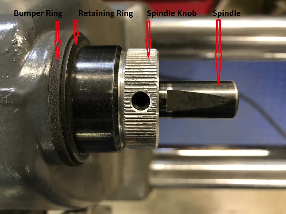

The link Ed posted gives a lot of information about it. Other than cleaning around/behind it the Spindle Knob does not need to be removed. It does provide a grip to turn the spindle by hand. It can be used as a visual guide for attaching Arbors and Chucks to the Spindle lining up the set screws as the Spindle Knob set screw should be in line with the set screw of attachments. In the picture below note that when properly aligned the Spindle Knob set screw is in line with the reverse tapered flat of the Spindle. The Spindle has a smaller reverse tapered flat for the Spindle Knob's set screw.
Unless it has some "burrs" keeping it from coming off it should easily slip off the Spindle with the set screw removed. If the Spindle Knob's set screw has been locked in a different spot than the flat on the Spindle a burr could have been created by the set screw digging into the Spindle. The Spindle Knob on my Mark V has a cup end set screw and on my Mark 7 a knurled cup end set screw. Both can make a burr on the spindle shaft so getting it on the flat is important. The cup type set screw's ability to dig into the shaft is why it is best to use flat end set screws on attachments. The reverse tapered flat of the Spindle helps keep the Arbors and Chucks "locked" on the Spindle.
The Spindle Knob is not used for setting mounting depths of attachments.

I've seen videos referencing the spindle knob can be used as an attachment adjustment by loosening the set screw and adjusting its position on the spindle. I wasn't talking about removing it for operational use, just for making adjustments. I had seen the thread referenced above and there seemed to be a lot of different opinions as to the knobs purpose.
I really just wanted to know if there was a model where it wasn't supposed to come off or be adjustable. Russ your comment on burrs makes sense. When I had first removed the set screw and tried to adjust my table saw blade, the knob would barely spin and the set screw was not in line with the tapered flat on the spindle. So I'm guessing it was cranked down on and created some burs which are preventing it from moving along the spindle.
I guess I have to try and figure out how to get it off now.

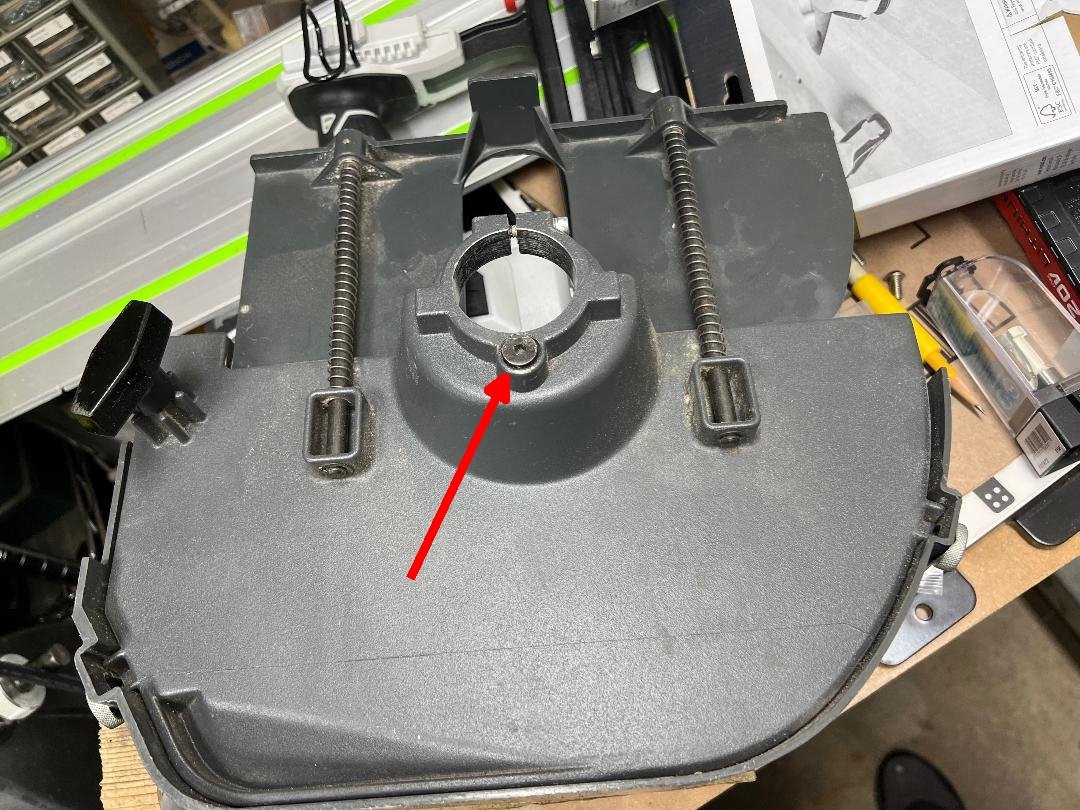

w8dev wrote: Tue Apr 05, 2022 3:16 pm https://youtu.be/e8P0TOUuQUk?t=175
Interesting but not correct. There is an adjustment on the lower blade guard for aligning the riving knife with the blade.
- David
Re: 510 Spindle Knob won't come off
DO NOT use this method. It is TOTALLY incorrect.
The adjustment is via this screw:
blade guard.jpg (225.23 KiB) Viewed 991 times
Anything other then is method is incorrect, period.
