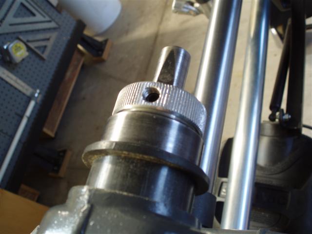

Is this the knurled collar that is being discussed?
[ATTACH]11490[/ATTACH]
[ATTACH]11491[/ATTACH]

That's the collar. Mine does exactly what you see in the pic. However this collar doesn't stop the quill from retracting, hold the bearings, none of that.
holsgo wrote:That's the collar. Mine does exactly what you see in the pic. However this collar doesn't stop the quill from retracting, hold the bearings, none of that.
There is a spring clip right behind that collar that can not be seen in these photos. Maybe that is what prevents the quill from slipping into the headstock.
Maybe that and the fact that the quill is too long to go very far into the headstock.
