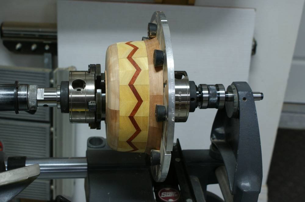

Yes the miter gauge remains at 0 deg. I used this jig when I have segments that are too high to be cut safely using the miter gauge for the angle. By laying the segment flat and then cutting the angles on each edge of the segment the segment can then be stood up on end with the angled cuts forming the left and right edge and then the segments can be glued into a ring. gravity is what holds the fixture to the way tubes. After the table angle is set and locked in place the Tweaker can be removed. By tall segments I mean as in the pic.

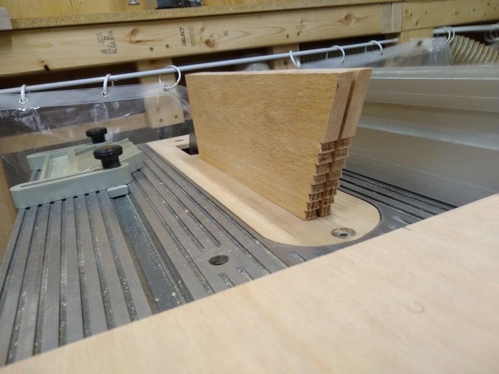

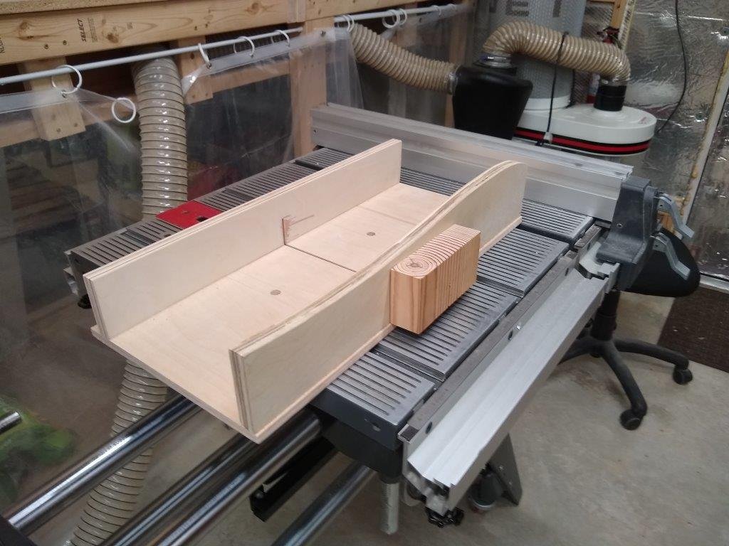

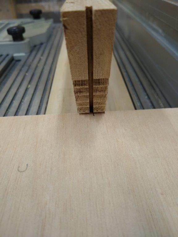

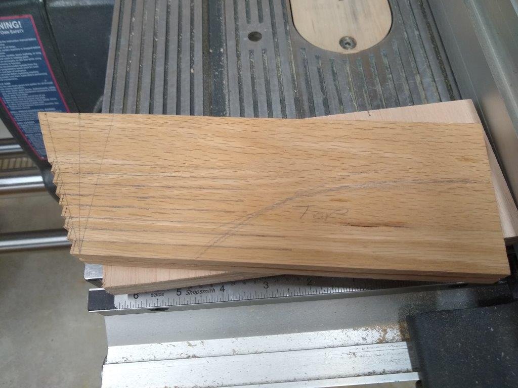

Heres another one Im trying out. It is mostly due to laziness. Instead of making actual measurements on blade distance to fence etc...I tend to make small tic marks on my boards where I want to cut them. Then i do my level best to hit those targets-sometimes its good, sometimes not so good.
The error occurs because the blade curves away from the board and its hard to gauge by eyeball if the blade aligns well to the tick mark on the board.
So i made this step gauge that uses the blade itself for self alignment and has a series of steps cut into its face to allow overhang/overlap with various board heights in 1/4" increments. It sets down on the blade and fits snugly-since the channel was made with the same blade.
The slot on the step face was aligned to the saw alignment slot on the bottom-the bottom slot is kindof drawn in pencil on the side of the board to give you an idea-it doesn't completely slot the board bottom.
Finally you can see how it works. You place the step gauge on the blade and slide your board up to the step face-where you can then clearly set your
blade to the tick mark on your board. The slot indicates the blade width-so its easy to setup for a left or right side cut on your tick mark.
You gotta be a little careful - as you could potentially bend your blade if you push sideways on something like this, but it definitely has improved my lazy accuracy.
