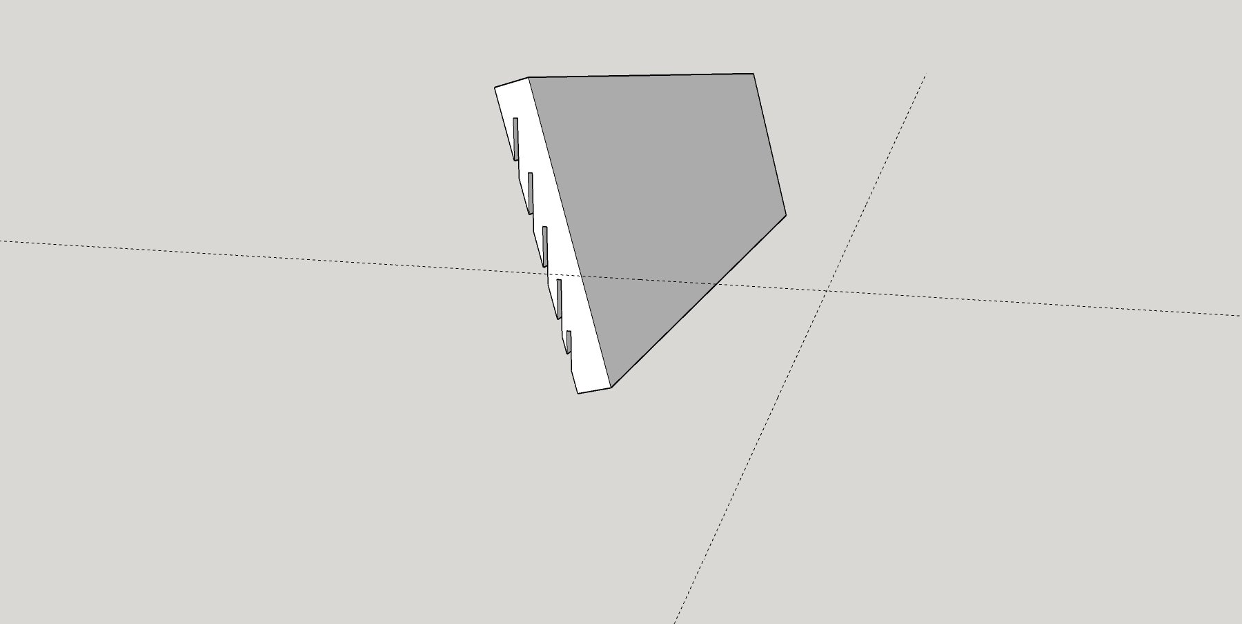

Won't work on a Shopsmith. Inadequate depth of cut. Dotted line is at 3.5".
Coin Rack Tiltede.jpg (47.6 KiB) Viewed 1269 times

dusty wrote: Fri May 06, 2022 8:38 am Won't work on a Shopsmith. Inadequate depth of cut. Dotted line is at 3.5".
I think this could be done using a near-horizontal router setup on the Mark. I don't recall ever running that small a bit at low speeds, but still thinking it could be made to work. Better with a PowerPro, but still kinda slow.(?) I think the OP has changed to 15 degrees off the other axis, a simple table saw setup.
- David

dusty wrote: Fri May 06, 2022 7:39 am
mountainbreeze wrote: Thu May 05, 2022 4:23 pm What Dusty drew is what was asked for however, I have since found that what he really wants is 15°, not 75° which is easy.
Thanks to all for the replies.
Depending on how you measure the angle, the sketch depicts 15 degree slots. Fifteen degrees with reference to which surface?
He is saying 15 deg on the Shopsmith trunnion scale (where 0 = perpendicular to the table) or 75 deg to the table.
