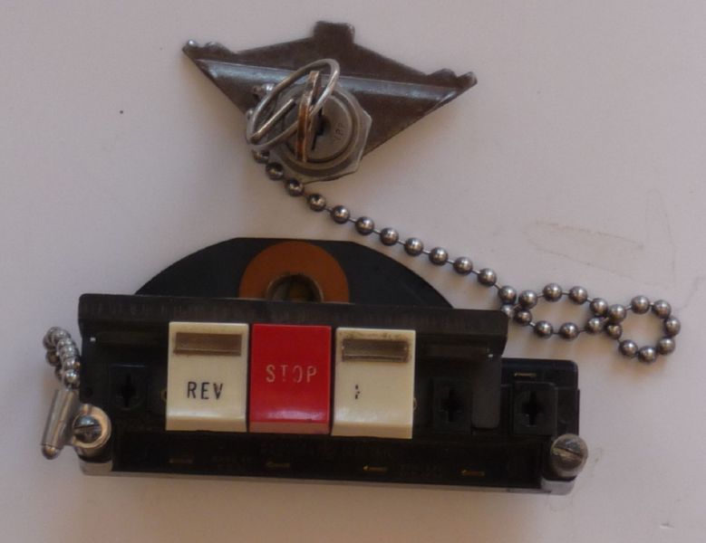

i disassembled the old switch, and it looks like you are right on the money JPG40504!!

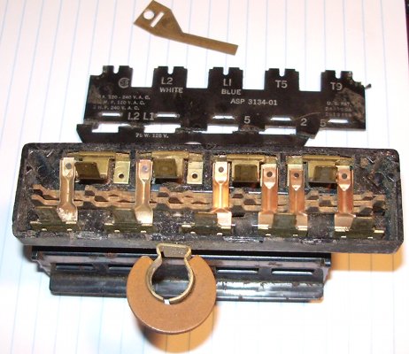

The old pushbutton switch is ingenious in its simplicity. I took pics, but, the 3 buttons physically move three independant hardboard "keys" horizontally. the hardboard keys hav various notches , and the different arrangements either push the contacts away, or let them spring together.
Anyway, by pulling the switch apart:
STOP: no connections (duh)
FWD:
L2 ----- L2
L1 ----- L1
5(r) x T5
2 ------ T5
2 x T9
5(l) ---- T9
REV:
L2 ----- L2
L1 ----- L1
5(r) --- T5
2 x T5
2 ------ T9
5(l) x T9
so , now I just need to wire up my new 3-way toggle switch!

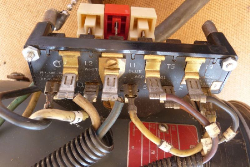

mk7-aosmith_motor and swtich and wiring-1.JPG (53.72 KiB) Viewed 4383 times

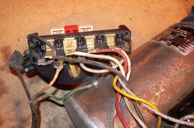

MK7-switch-external and wiring-1.JPG (41.85 KiB) Viewed 4365 times
