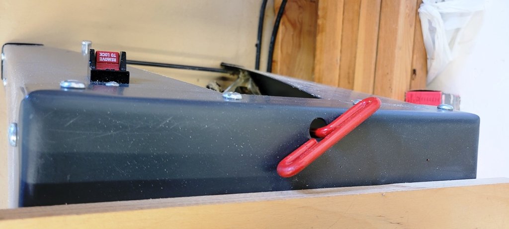

I just checked my late 90's Band Saw power stand and my late 90's Pro Planer stand and they are identical. The top decks are the same size (18" X 13") and the holes on both are the same. The planer mounts with two bolts, one on each side.
The band saw stand has the two holes to mount a MK mount planer. I assume the MK mount planer has the same mounting points for the stand as the Pro Planer since SS used to sell a stand kit for it.
If you look at the lead in picture at the top of SS web page you can clearly see the same hole as the one in my Band Saw stand. There is one hole on each side of the stand.
So to JPG's question the "new" stands seem to be identical to the previous ones and a MK mount planer will mount, no drilling of holes required.

chapmanruss wrote: Sun Jun 12, 2022 12:47 pm Except for my Pro Planer stand I have not owned a Power Stand. Ones I have seen have the power switch box like the Pro Planer without the feed speed control so for me it is interesting that the switch for the new Power Stands was used before. John, thank you for pointing that out. I love learning new things about the Shopsmith Tools. Below are two examples of Power Stands I have seen.
_
I have never seen the stand in the upper picture. It doesn't have the planer mounting holes. However it does appear to have the motor mounting slots like the second picture. You can see the ends of them on the left side of the SPT mount casting. Since it doesn't have the planer mounting holes I guess it predates the planer SPT.
