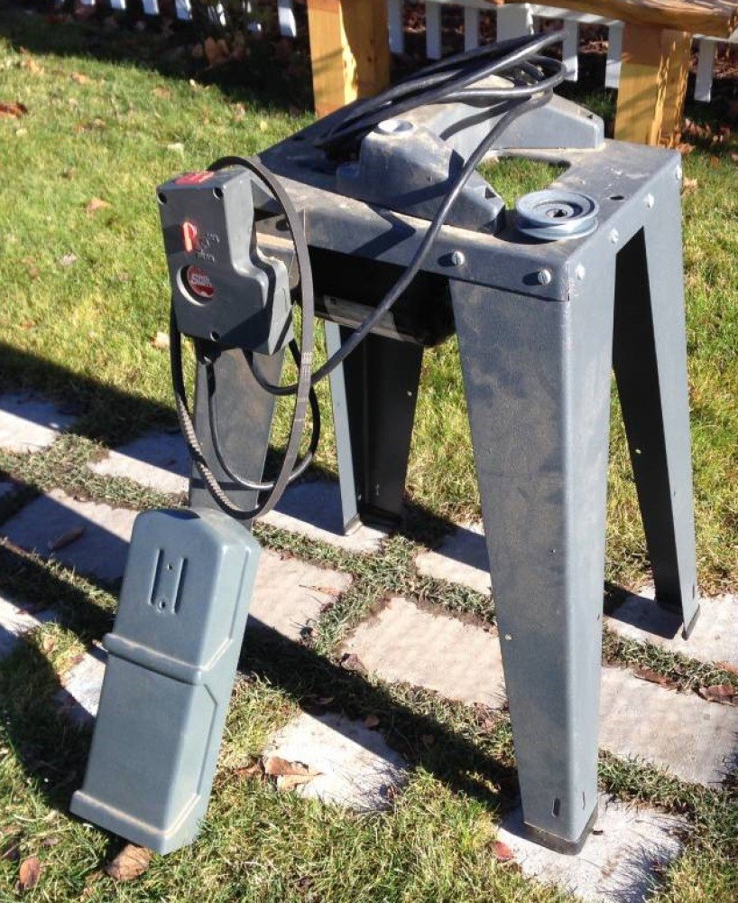

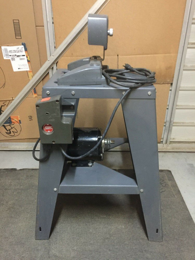

Except for my Pro Planer stand I have not owned a Power Stand. Ones I have seen have the power switch box like the Pro Planer without the feed speed control so for me it is interesting that the switch for the new Power Stands was used before. John, thank you for pointing that out. I love learning new things about the Shopsmith Tools. Below are two examples of Power Stands I have seen.
_
SPT Power Stand lower motor.jpg (125.13 KiB) Viewed 1207 times
SPT Power Stand higher motor.jpg (228.23 KiB) Viewed 1207 times
