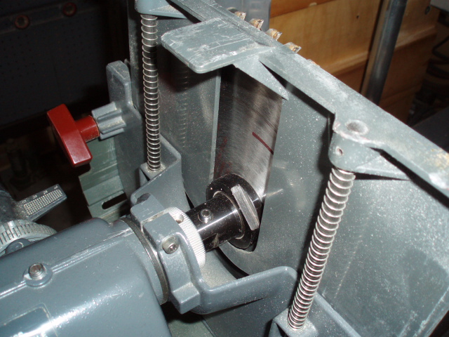

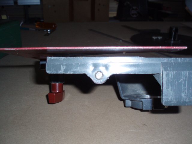

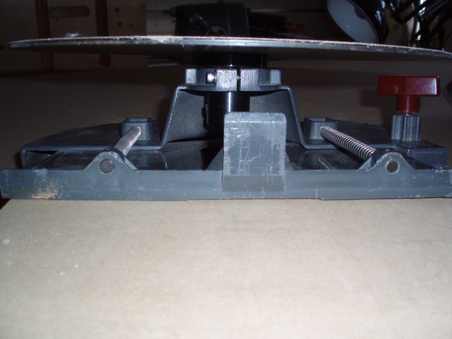

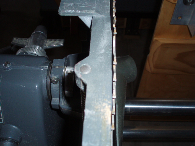

It looks like the lower blade guard is bent, as though it were lying flat and weight was applied to the spindle mounting area, forcing the mounting area in, towards the center. I think the surface closest to the headstock should be flat and perpendicular to the spindle. Photos 7,1144,1146 show the center pushed in closer to the blade and both the front and rear to be angled out, towards the head stock.

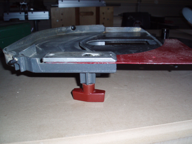

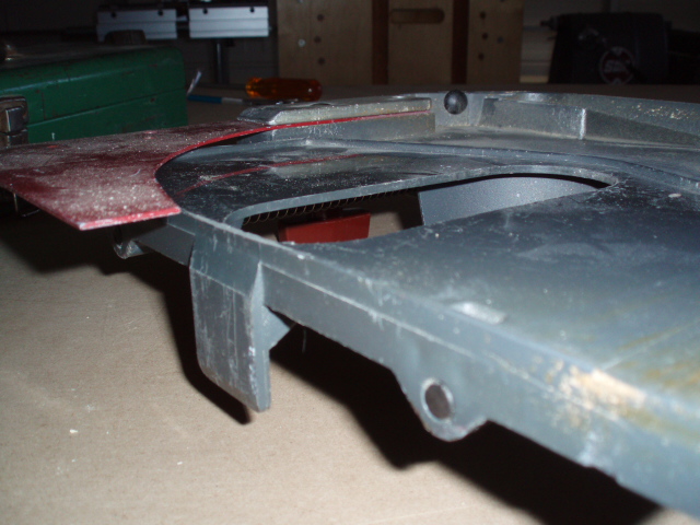

colday; I am almost convinced that your original diagnosis was correct. It is hard to believe that the casting is malformed but your total set of photos is rather convincing (or confusing).
Before viewing your last post, I took some photos of my own.
I took the plastic shield off so that I could better view the riving knife with respect to the casting. BTW The riving knife shown is a homemade version to be used when I do not want the upper saw guard in place (when cutting bevels).
- P2110018.JPG (141.72 KiB) Viewed 14246 times
- P2110019.JPG (153.16 KiB) Viewed 14242 times
- P2110020.JPG (150.28 KiB) Viewed 14236 times
- P2110022.JPG (129.92 KiB) Viewed 14233 times
- P2110023.JPG (151.63 KiB) Viewed 14231 times

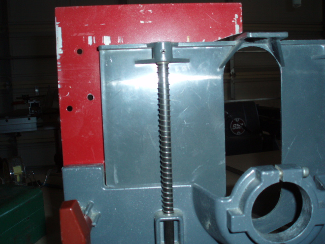

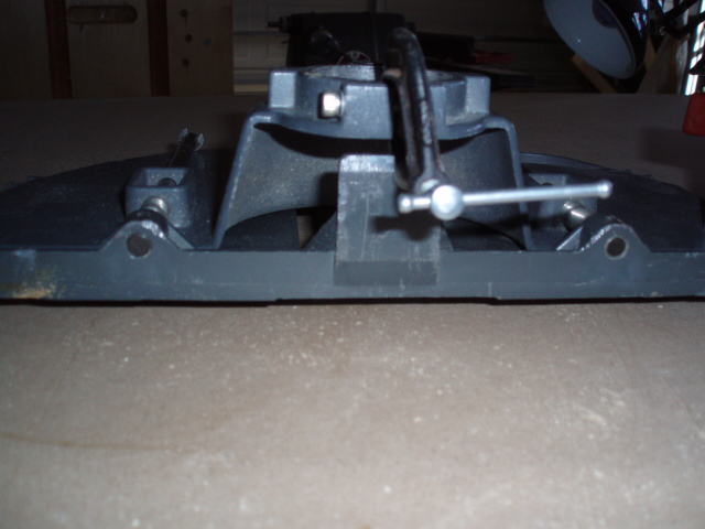

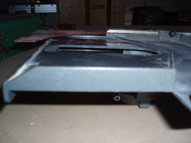

Lower Saw Guard & Riving Knife
A continuation:
- P2110008.JPG (161.34 KiB) Viewed 14229 times
- P2110009.JPG (141.1 KiB) Viewed 14219 times
- P2110014.JPG (136.48 KiB) Viewed 14218 times
- P2110015.JPG (138.19 KiB) Viewed 14215 times
- P2110019.JPG (153.16 KiB) Viewed 14228 times

Looked at all the photos two or three times. Yep- looks like the lower saw guard is bent/warped. If it were mine, I'd try to straighten it.
There is a horizontal strip of aluminum near the bottom of the part. Its side is supposed to be firm to the headstock side of the guard. I think it's purpose is to stabilize the plastic in the guard. Perhaps the guard was bent and at the same time a piece of wood got wedged between this horizontal piece and the side of the guard? If so this could cause the bend.
Wishing you good luck and stay safe!
