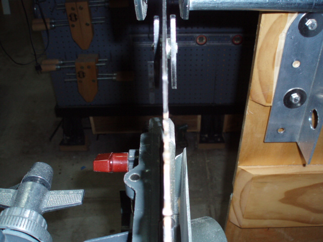

Do you have another saw blade and arbor, I sure hope so. In the photos you posted, it almost looks like you have a wobble dado blade installed. Make sure that the blade is on the arbor squarely and firmly.
Now to the riving knife...I now assume a standard arbor and properly installed blade...have you adjusted the riving knife at all. You cannot see or adjust the alignment screw with the saw guard installed. It is neatly tucked away out of sight when the saw guard is mounted. Pull off the lower saw guard and look at it from the position of the headstock. You will see an adjustment screw. This screw moves the riving knife laterally for alignment to the blade. Unfortunately, this adjustment cannot be made with the saw guard mounted. It is a hit and miss proposition. Adjust, mount, look, dismount, adjust, mount, look........
if the riving knife is to the left of the blade - back out the set screw (counter clockwise)
if the riving knife is to the right of the blade - screw the set screw in (clockwise)
I need to take a trip to the shop but that will have to be later in the morning. Never fear..the forum.. is here. We'll have this sucker running straight and true...gotta...you need that riving knife!!!!
I took a couple photos while sipping my first cup of coffee. Hopefully these will address your situation.

Right now, sawdust has priority.
[ATTACH]3271[/ATTACH]
[ATTACH]3272[/ATTACH]
- Perfect Alignment.jpg (145.65 KiB) Viewed 19966 times
- Riving Knife Alignment Screw.JPG (145.85 KiB) Viewed 19968 times

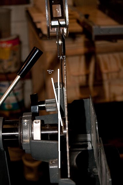

Hi,
I've looked at the pictures and I would have to say it looks like the lower guard is bent. I guess like anything else this could happen.
The "A" line should be a plane and on yours it looks like it is bent like the "B" in the photo.
[ATTACH]3273[/ATTACH]
You could attempt to bend it back but I have no idea how well that would work... still might be an option knowing that it will not work the way it is. Perhaps someone has experienced this and can lead the way???

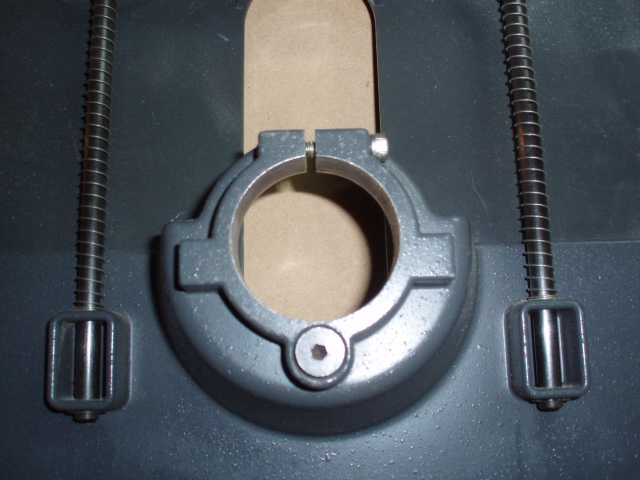

lower blade guard mount???
Since I do NOT have a blade guard, I am surprised it is mounted INSIDE the knurled aluminum collar. Does this mean you must remove both the collar AND the lower guard in order to use SS as a NON saw function?? When I purchased my SS the blade guard was an optional extra cost accessory.
BTW Looks bent to me! Think the 'wobble' is caused either by camera angle or the arbor is dangling loosly on the shaft????
No, you do not remove the knurled collar. The blade guard goes over it with plenty of clearance. I take the blade and the blade guard off together and I pull the blade inside the lower saw guard and install both at the same time.jpg40504 wrote:Since I do NOT have a blade guard, I am surprised it is mounted INSIDE the knurled aluminum collar. Does this mean you must remove both the collar AND the lower guard in order to use SS as a NON saw function?? When I purchased my SS the blade guard was an optional extra cost accessory.
