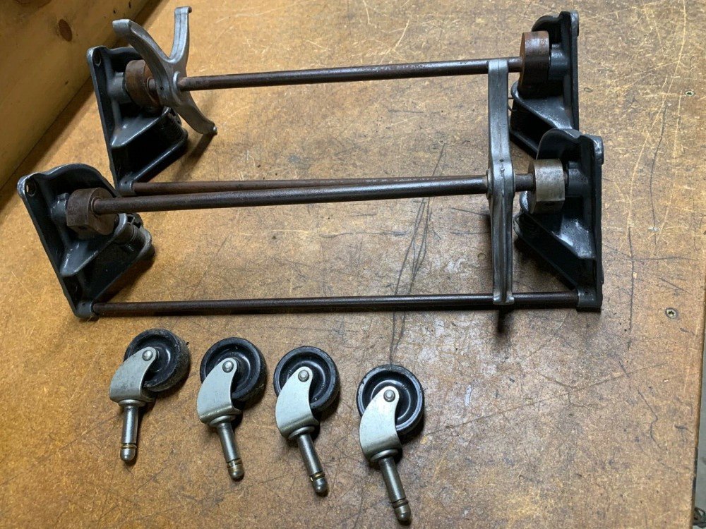

It's 8 months later, but I finally gained back space in my tiny shop and retrieved the SS and all it's accessories. Actually, I cleared the space out back in October, but somebody else needed it more than I.
Anyway, the first thing I noticed is the lack of casters on the Power Station...and those legs don't have a natural spot to poke standard casters in. I watched Scott's "Regrets" video which covers the addition of caster assemblies to his PS. I think they're a little pricey, but I do like the idea of legs resting directly on the floor better than hoping that a locking caster will actually stay put. I was ready to order a set--but the catalog confused me.
1) the caster page refers to a "power stand" -- will these fit the Power Stand also?
2) what do the extended height casters get you?
Oh, and I'm definitely replacing the Mark V wheels with the gray thermoplastic ones. Looks like the previous owner stuck some plastic bed- frame rollers down there.

CreekWood wrote: Fri Jun 16, 2023 12:32 am It's 8 months later, but I finally gained back space in my tiny shop and retrieved the SS and all it's accessories. Actually, I cleared the space out back in October, but somebody else needed it more than I.
555353 will fit the Power Station, most (IIRC) of the old Power Stands, and evidently the new Power Stands. These appear to be the same as the current Mark casters except they include different mounting hardware.
These would go with the 'new' height extensions for the 'new' Power Stands. My guess would be they include different mounting hardware compatible with the larger footprint from the extensions.
The bed-frame rollers might be the OEM wheels. I have not tried the gray thermoplastic ones. I like the large wheel upgrade that SS sells for Marks, but it might be overkill to adapt it to a Power Station. IIWM I'd consider buying the 3" complete assemblies for the Mark and then re-use the Mark caster sets on the PS. It's a little more money. How much better the 3" wheels work depends a lot on the quality and finish of your shop's floor.
- David
Posts: 4533
Re: I have a friend (with a SS Mark V)
The Power Station uses the same Retractable Caster Assembly as the Mark V models, Mark 7 & 4. The difference is they use round plastic spacers between the legs and Caster Assembly ends plus longer screws. Sorry I cannot give you the spacer dimensions or screw length. Right now everything is packed and getting ready to move. On my Power Stations I use the regular 2" casters which with their lighter weight works fine for me.
The picture below shows the 2" plastic wheels that have come on the Retractable Caster Assembly for decades. Previously they were metal wheels.
_
Retractable Casters - Mark 5.jpg (222.75 KiB) Viewed 2594 times
IIRC the spacers used with the power station are 9/16". The screws need to be correspondingly longer.
Note power STATION , NOT power STAND.
