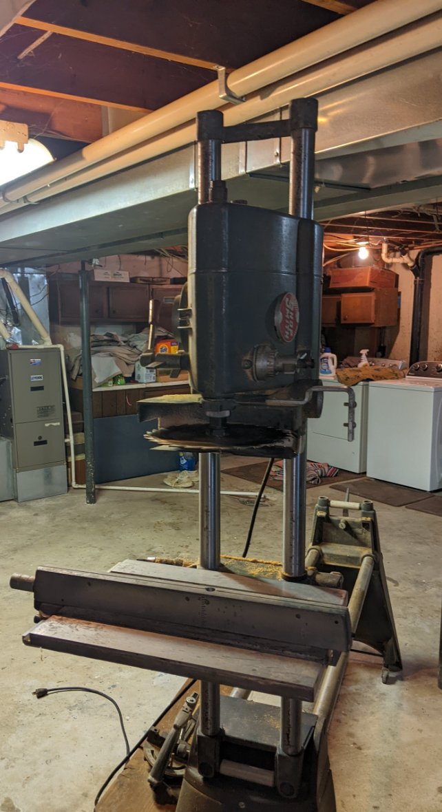

Re: I have a friend (with a SS Mark V)

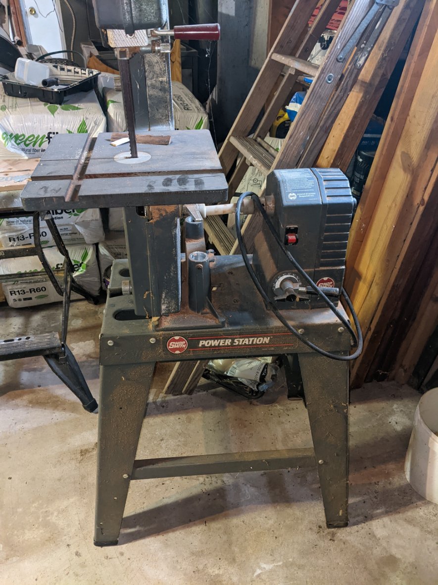

- This was in with Shopsmith accessories, but does it have anything to do with the Mark V?
- PXL_20220905_174508188.jpg (187.87 KiB) Viewed 5466 times

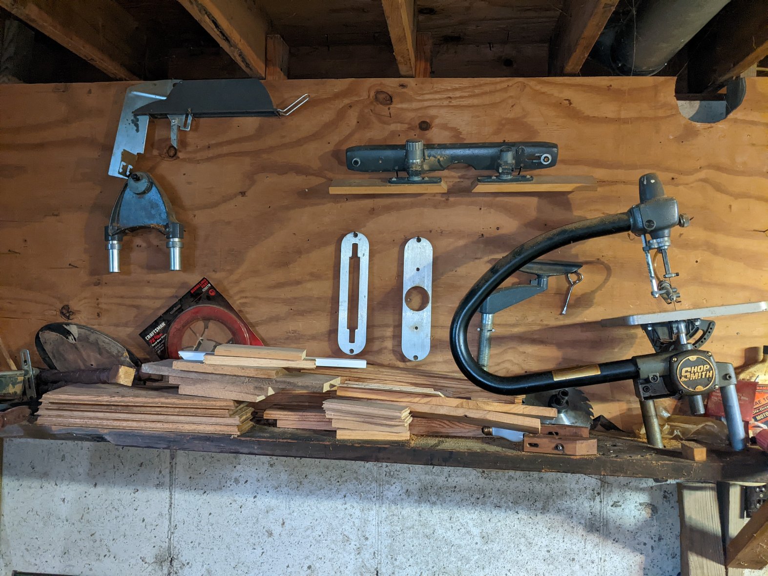

There is a saw guard--we just took it off as we were poking around. Eventually we got the saw arbor off and located a drill chuck.
- PXL_20220905_174840029~2.jpg (133.37 KiB) Viewed 5465 times

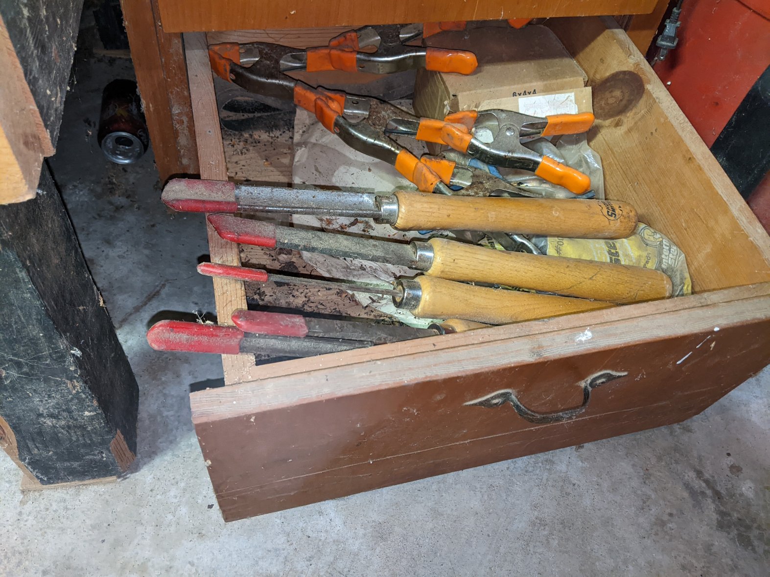

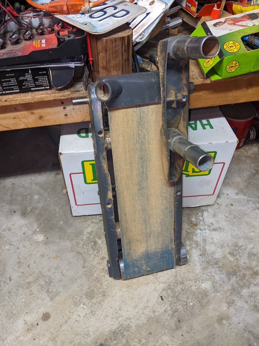

And the other items...that we know of. The good part about buying from a friend is that if I were to find something missing, I know I can go back and search for it.
- PXL_20220905_174109583.jpg (224.24 KiB) Viewed 5465 times
- PXL_20220905_173926591.jpg (217.47 KiB) Viewed 5465 times
- PXL_20220905_174432238.jpg (359.45 KiB) Viewed 5465 times
- PXL_20220905_174246325.jpg (373.51 KiB) Viewed 5465 times
- PXL_20220905_180612386.jpg (427.23 KiB) Viewed 5465 times

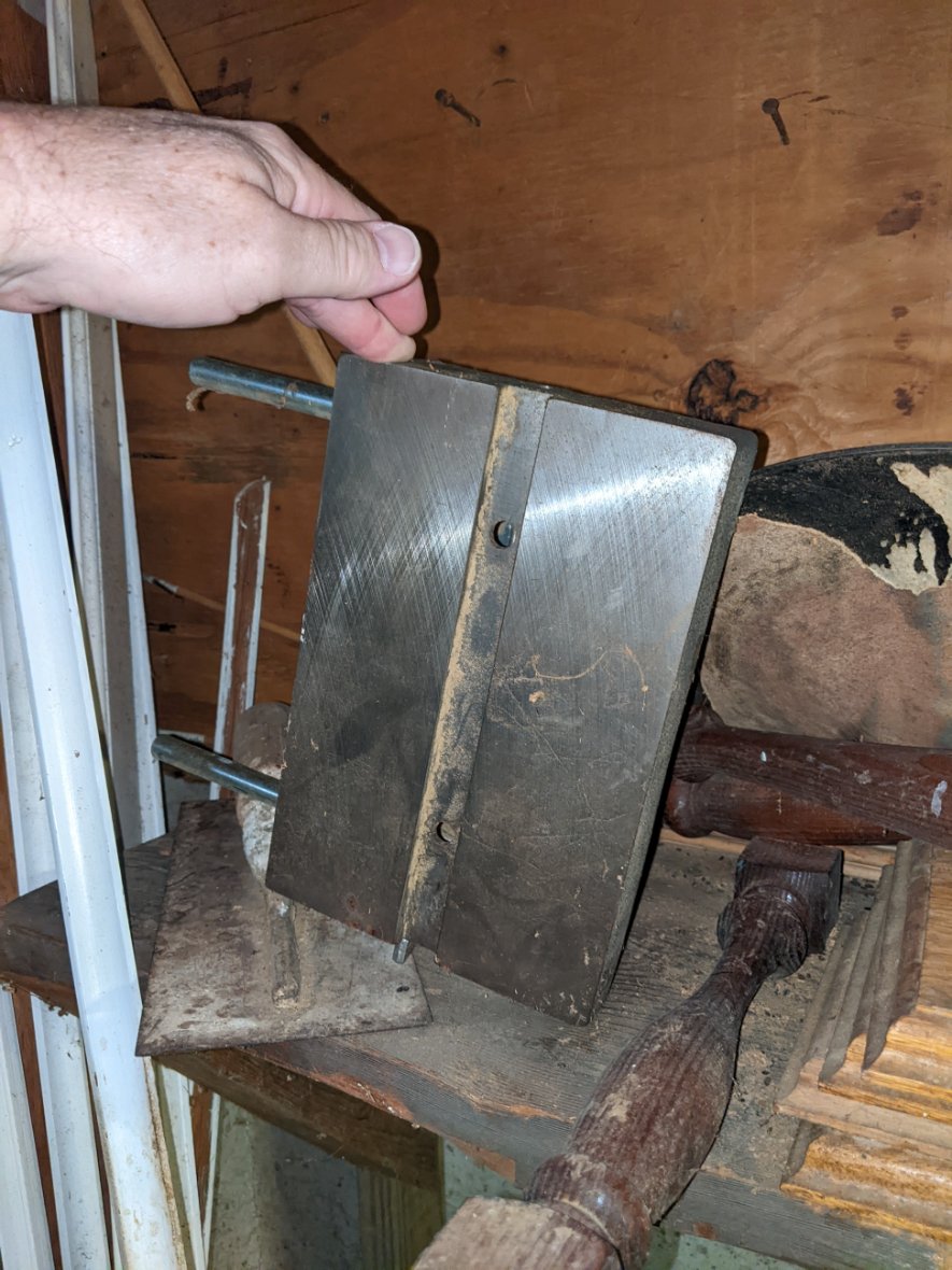

First photo is the worktable for the belt sander.
- 98EE0D50-92DD-44A6-8C19-DDA6D407160B.jpeg (82.14 KiB) Viewed 5456 times
The first pix goes with the belt sander. Check previous post.
