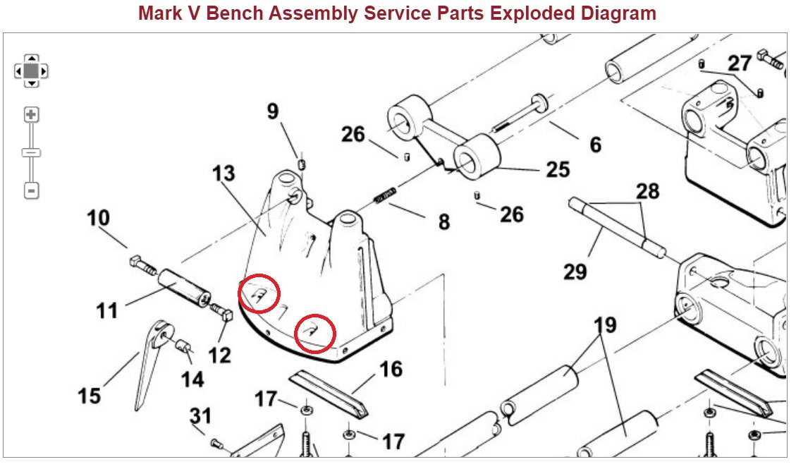

Hope SS takes care of you. Well, I don't have any other features to explain, but I have always wondered about the two holes in the left headrest (marked in red below). Hopefully someone knows the true intent of these and can explain them. I know many use these holes to hold the SS toolkit (5/32" hex wrench) or the drill chuck key, but I assume this wasn't the original intent of those holes.
P.S. Guessing these holes were originally intended for mounting for moving, e.g. crate shipping:

Now about them holes. A likely carry over from model 10 thinking re a bench mount configuration rather than having integrated legs.

The holes in the base of the Headrest, as understand it, is a place to store the Shopsmith Toolkit aka Allen Wrench and the Drill Chuck Key. Not having received a Mark series tool new I don't know if the holes were used for shipping purposes. The Mark V 520 I received from my father-in-law was assembled at the Shopsmith Factory Store in Tigard OR before he picked it up.

chapmanruss wrote: Wed Oct 12, 2022 1:10 pm The holes in the base of the Headrest, as understand it, is a place to store the Shopsmith Toolkit aka Allen Wrench and the Drill Chuck Key. Not having received a Mark series tool new I don't know if the holes were used for shipping purposes. The Mark V 520 I received from my father-in-law was assembled at the Shopsmith Factory Store in Tigard OR before he picked it up.
Russ,
Thanks. Yeah, this is what I always thought too, but then to answer my own question I went searching the forum this morning and found the document linked below. In figure 3 they show it being used to attach the Mark V to a pallet for shipment and the text describes this as well. I never knew this...seems like the tool storage is a secondary feature for these holes and a "bonus"!!!
https://www.shopsmith.com/ownersite/pro ... ipping.pdf

JPG wrote: Wed Oct 12, 2022 1:34 pm Well! That certainly makes much more sense!!!!
I know, right? Those two holes definitely look very purposeful, which I guess is why they make indentations there beside each hole for more structural support perhaps for this function? Wouldn't need those if just making 2 holes for holding hex wrenches. There is so much knowledge tucked away on this forum. I know I have only been here a short time, but I have only respect for the many that have come before me on this forum. Thank you all!!!
P.S. Credit for this little nugget about those two holes goes to a forum member named charlese back in 2008:
viewtopic.php?p=19876
