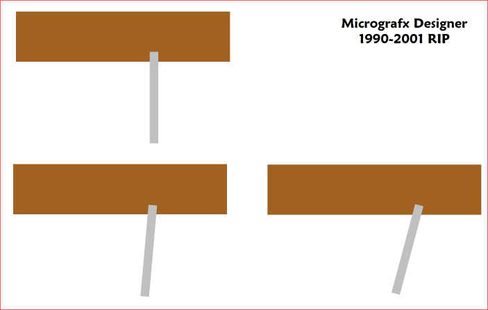

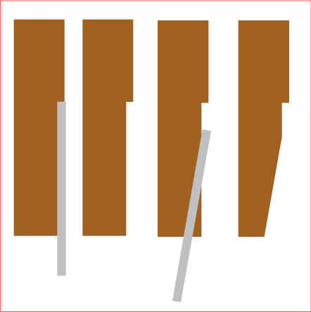

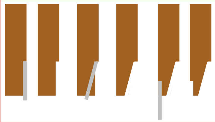

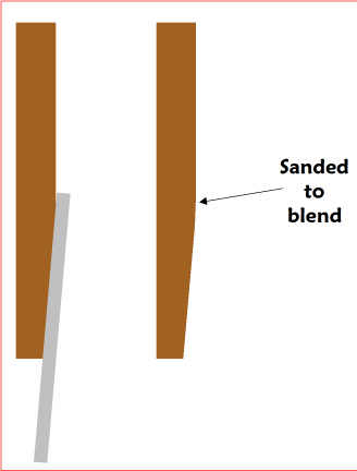

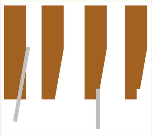

Sorry I don't have the time to get to into this but I made a couple of drawing which might get help out in the idea's department. This is no where near all the options you have.
Take a look at figure 4-21 where the inlay is done... now picture that as your panel... or maybe something like 4-18 or any other decorative cuts you can think of for the panels... So sometimes the raised bit of the panel can be understated because you don't want to take away from the panel itself.
I've also used a sander to round the angle so it is a smooth flow... make it longer with a 5 deg cut and just blend. You can also play with different thickness of panels or as shown center a thicker panel with a back cut.
So these drawings show the panel and with blade then resulting cut and additional cuts... I'm sure you can figure it out.

PTWFE Chapter Table Saw Special Opts CH4
Loved Ed's drawings Take your choice of any of the above!!!!
I believe there are as many methods to make raised panels as there are woodworkers. I have always used the method of sawing a kerf into the face of the panel as a first step. This method does several things for me:
--The kerfs define the face of the panel and if there are matching panels to be made, they will all have the same sized, keen edged faces.
--The depth of the kerfs determine the height of (or the reveal of) the raised panel from the sloped edges.
--When sawing the slopes, the blade is set so it just barely touches the bottom of the kerf. The angle of the table is set so you get both the width of the desired slope and the desired thickness of the outside edge.
EDIT: I use the first block of Ed's illustrations, with this exception. The first cut is not made from the edge as shown, it is made from the face. ((right angles from what is shown in illustration #1)
