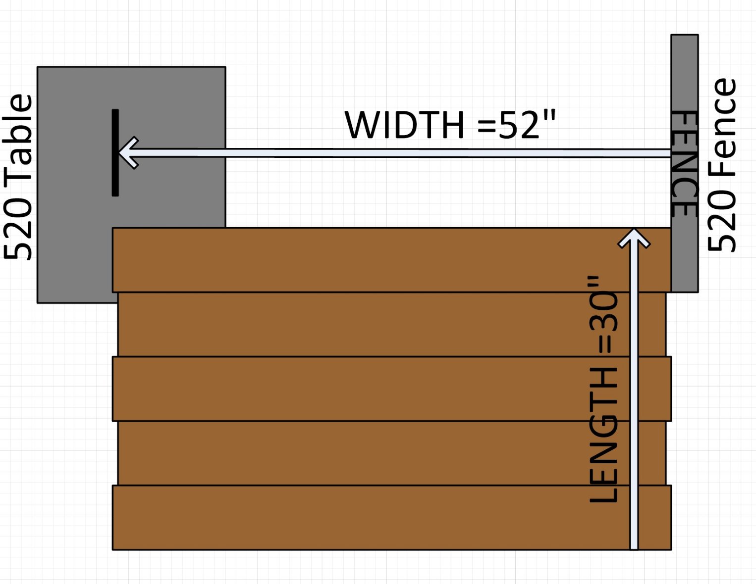

You guys are welcome to make any tablesaw cuts that you feel safe and confident in doing. This panel is 30" x 52" and would be similar to cutting a sheet of plywood on the Mark V, albeit it is a bit smaller. My understanding is that the risk of kickback is proportional to the width/length, where width is the distance from the fence to the blade and length is the length of the panel that rides against the fence. As a rule of thumb, you want the width to be less than the length to be more confident in not producing a kickback from the panel's aspect ratio. So, in this case to cut off the staggered ends, the width is 52" (or slightly less) and the length is 30". So, this means your width/length = 52"/30" = 1.7333. This is NOT a safe cut in my opinion. Anything approaching "1" or above "1" is at a higher risk of kickback based on this kickback guideline I was taught, i.e. you want width<length. Unless I am misunderstanding what direction and how you are attempting this cut on a Mark V, I think you are tempting a kickback here as the risk ratio is quite high. Crosscutting panels like this are exactly why crosscut sleds were invented to NOT use the fence as a reference so as to minimize side-to-side play and make the cut safer. JMO.

Just to make sure I understand, which end has the "staggered" ends, i.e. the ones to trim and square up? My assumption has been that the staggered ends are on the short end (30"). So, this requires a "crosscut" with 52" between the blade and fence (if you use the rip fence method discussed by David). Is this correct, or did I misinterpret which ends need to be squared? See below drawn to scale, though staggered ends are exaggerated for visual effect.

I can't remember where I learned this rule of thumb, so it is hard for me to clarify. Also, I wondered when I posted it whether the "length" parameter should be the length of the fence rather than the length (crosscut width) of the workpiece. It would seem to make more sense if it was the fence registration, but I am not sure how the rule was intended. The guideline I posted makes sense to me because it is just saying that the risk is proportional to it, so for example, the 2x4 crosscut example mentioned earlier makes perfect sense because for a long 2x4 registered against the rip fence, kit is going to be many, many multiples above "1" for that ratio which is why it would be so dangerous. Also it doesn't pass the common sense test, i.e. why crosscut a 2x4 using the rip fence rather than a miter gauge? When I think about the lateral (side-to-side) play of a workpiece it makes sense to me that for a rectangle (narrow end going up against the rip fence) it will be much worse than for a square or a rectangle (long end going against the rip fence). At least in my mind when I visualize it, it does. In other words any error in feeding the workpiece against the rip fence is going to be amplified more for a cases where that ratio approaches "1" or much greater like in the case of a 2x4. The longer and more narrow the panel, it starts to approach the case of a long 2x4...is this panel too narrow? That is the question.
Just because the kickback risk has gone up, doesn't necessarily mean you can't do this cut in this manner. I just wanted to highlight the greater risk for cutting at this aspect ratio on a tablesaw. You just want to make sure that you do it as safely as possible. Very important to minimize any play when you feed it into the saw and keep that back edge engaged against the rip fence at all times. A suitable hold down device like Jessem's Clear-Cut TS™ Stock Guides, which I have praised many times in the past on this forum, "might" help as well...though I question their effectiveness with the rip fence so far from the sawblade for this type of cut.
P.S. In the 2x4 example, the fence "length" doesn't matter right? I mean you could have a 6' long rip fence, but that 3 5/8" length of the 2x4 is the true "length" to consider to figuring out the aspect ratio and kickback risk as defined above. In other words, a longer rip fence won't make a 2x4 crosscut using the rip fence any safer. So, I guess I answered my own quandary from above - length has to be length of the workpiece in the crosscut direction.
📶RF Guy

To answer you first question RF Guy - Yes... your assumptions are correct. That is the cut I'm attempting. Can I ask what you used to sketch that up? I like it. Is it SketchUp?
