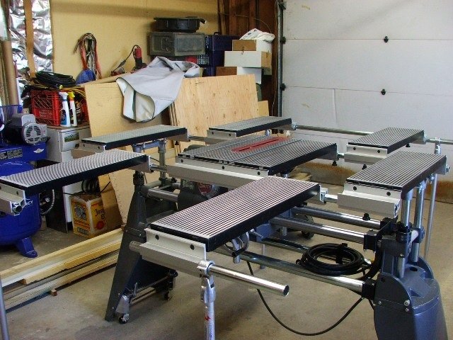

The size and weight of that kind of panel make it quite precarious to cut on a Mark V. Can it be done? Yes. Can it be done safely? Debatable. It sounds like you need to square the ends so a crosscut sled is ideal but just feeding it into the small main table is a challenge. Even a decent size, dedicated table saw would be a bit tricky, though easy on a big sliding tablesaw machine. You could also try to rip it (with adjustment to the one end to make it square) but be very careful with this because it doesn't take much to get the panel out of alignment and produce a kickback event. I forgot about using a router and that is a great suggestion. Safest approaches in my mind are tracksaw, circular saw + straight edge or router + straight edge. Good luck. Stay safe.
P.S. You need something like this if you want to cut that size panel safely on a Mark V:
viewtopic.php?p=188041#p188041
- InfeedOutfeed.jpg (88.42 KiB) Viewed 2405 times

As others have already suggested I believe a track saw or circular saw and straight edge would be the best way to go for the length of the panel you are working with. Even though I can do the setup RFGuy shows in the picture above I would not try cutting it that way as my first option. Too easy to get that large a piece out of alignment. I have a circular saw and straight edge guide I would go to first. If I was cutting the 30" to width than I would go with the Shopsmith.
