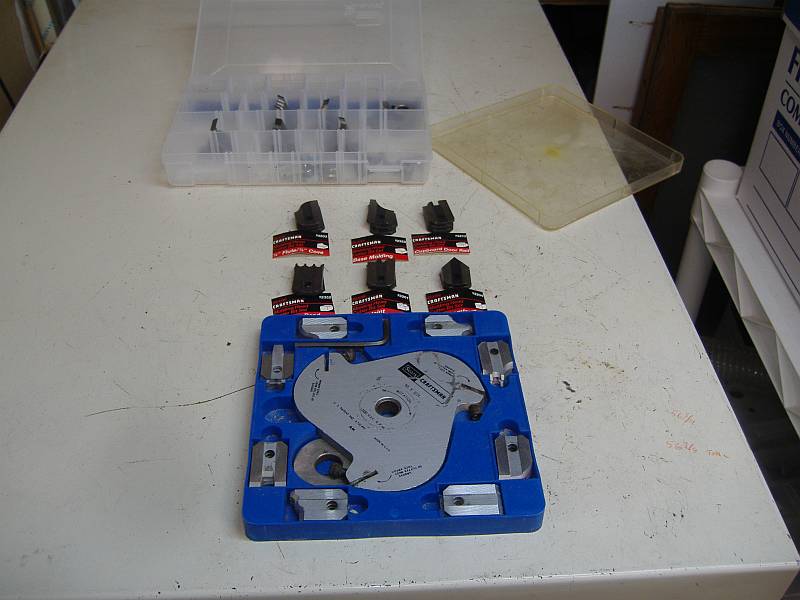

I too have the craftsman, but they have had a few different ones. I was given one that had only one cutter! That was something I never tried... I guess it was cheaper that way but still worried me a bit too much.
Here is the picture of the one I use.
[ATTACH]3490[/ATTACH]
