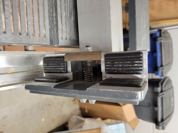

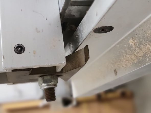

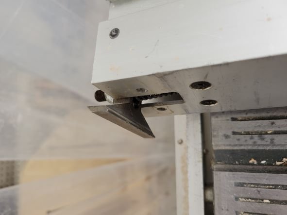

I've got NO pad(s) on the back (outfeed) part of the fence. It is merely a metal wedge type piece that clamps onto the rail. There are plastic? pads on the infeed part of the fence. Note on the pix, two of them are taken with the fence laid on its side. One of the two outfeed images is shown with the fence in position resting on the the table ready to clamp. (Sorry, no matter what I did I couldn't post the last two images in the orientation taken so they make more sense. Tried multiple time
Also I need to clarify the original posting I made, when I said " "At the back it is right on the table top." I meant that the the bottom of the fence is resting on the table.
Also David, I couldn't find an exploded view of the fence that matches part #228 you mention. I did find a part list that lists reference #228 as part # 518423 "Rip Fence Rear Pad for M7, 520." And that part # matches to a exploded list on the upgrade package manual - https://www.shopsmith.com/ownersite/pro ... adePkg.pdf.
If you all are talking about pads on the bottom of the fence itself that ride on the tabletop, I don't have those on my fence. The only pads I have are on the clamping part of the infeed side where the clamping system rides on the front rail.

That's the correct part, this is the view I was talking about: https://www.shopsmith.com/service/mark/ ... iagram.htmhfmann wrote: Fri Feb 17, 2023 12:30 pm Also David, I couldn't find an exploded view of the fence that matches part #228 you mention. I did find a part list that lists reference #228 as part # 518423 "Rip Fence Rear Pad for M7, 520."
Yours is missing, the mounting holes appear to be present. And it looks like it was once there, so maybe just got knocked off or the mounting features might have broken.(?) Looks like it just clips in place with clips that are part of the pad inserted in the holes. I'm reluctant to pop one off to confirm though.

[/quote]That's the correct part, this is the view I was talking about: https://www.shopsmith.com/service/mark/ ... iagram.htm
[/quote]
thanks David,
I didn't look closely enough and thought all those holes (4) had screws in them. Now I see those two holes furtherest to the end of the fence are indeed empty.
