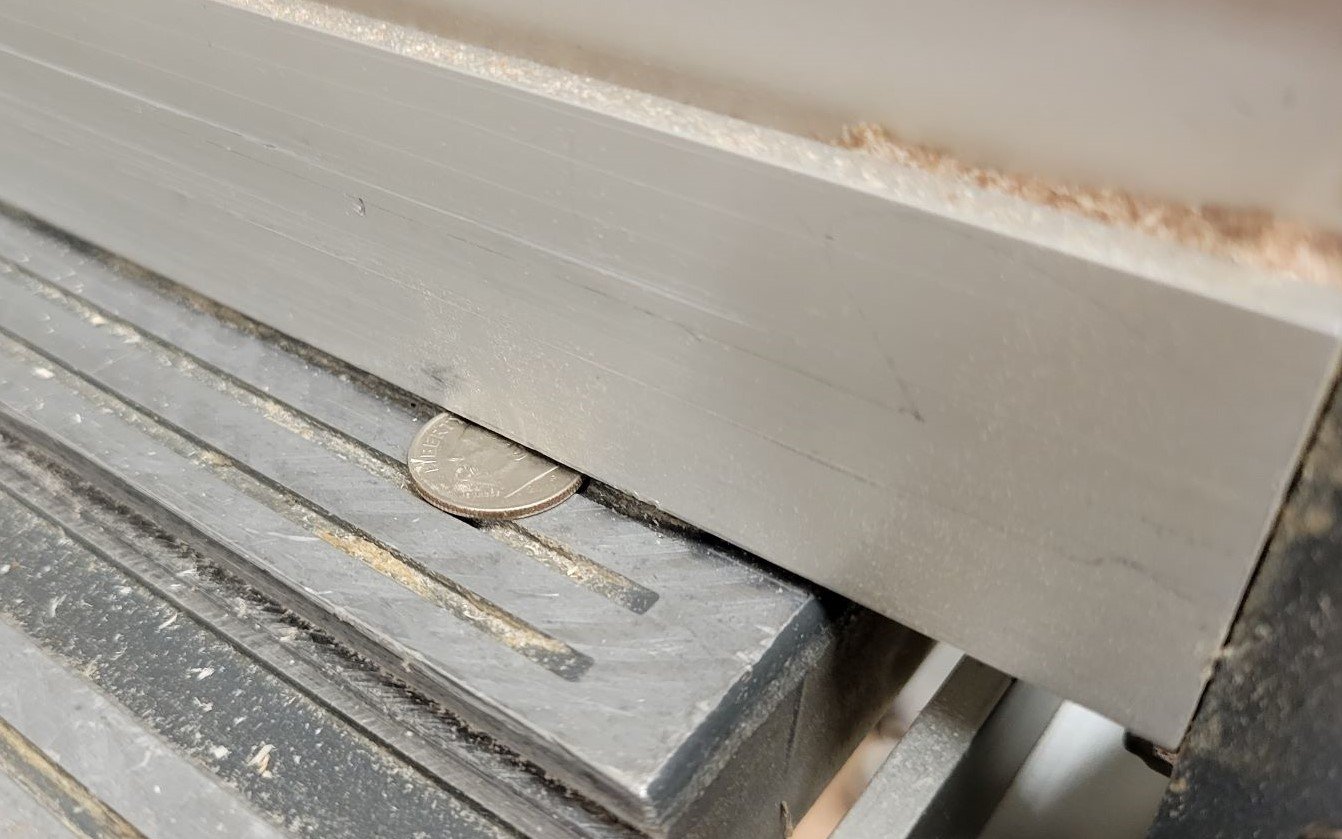

I found the front of my 520 fence floating quite a bit above the table when locked in place. At the back it is right on the table top. I sure don't know how many years ago I upgraded to the 520 rails. So I can't find the alignment gauge the upgrade manual calls for. I'm assuming my front rails are not spaced correctly from the table top. Anybody know of a way to correct this situation without buying another gauge from SS?

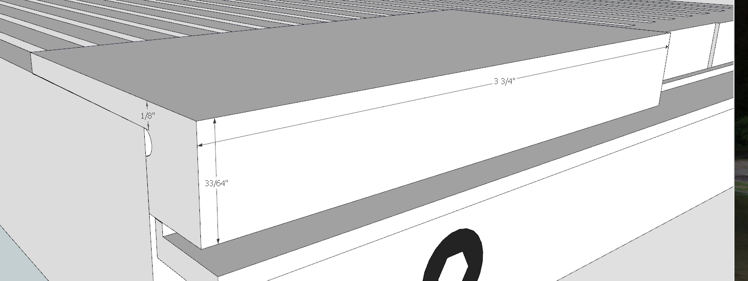

This might help.
Dimension is not critical so long as it it the same at all points along all rails.
My sketch shows 33/64" but that might actually be 1/2" if I remeasured. A 1/64" error is easy to achieve with a caliper unless you are real careful and somewhat skilled. That does not describe me!

Outstanding Dusty,
I assume that is a drawing with the actual measurement of the SS alignment and setup gauge.
edited: Ooops, now I see you note the measurements don't have to be precise, just uniform in all places. Thanks.

The sketch is intended to depict actual measurements of my gauges. It does lack high level of precision"hfmann wrote: Thu Feb 16, 2023 12:19 pm Outstanding Dusty,

Hmmm. Getting back to your first post - yes, that's what you said. Maybe a different problem than rail alignment? On mine, sample of one, a dime I measured at 0.051" will fit under the fence at both ends but is very snug in the front. A penny (0.060") won't fit under either end, not even close. The contact points are hard rubber (or similar) pads on the front fence casting and a nylon (or similar) block on the rear. I'm calling the front the infeed side for table saw operations. I measured with the locks in the locked position.hfmann wrote: Thu Feb 16, 2023 3:30 pm Interesting. I used a digital gauge and difference between front and back was .07.
