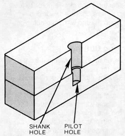

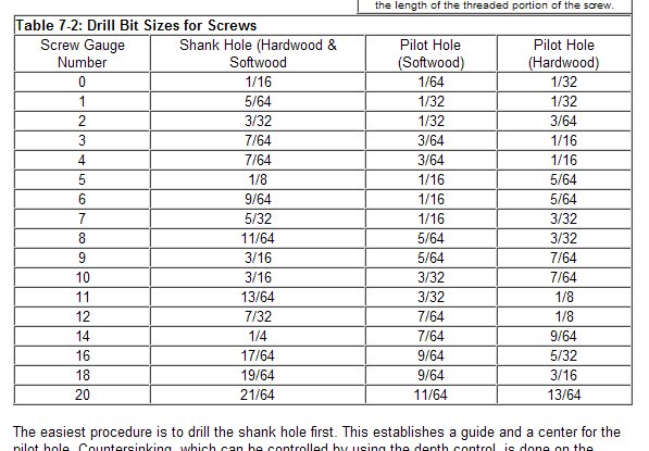

OK Tim you have lost me here...
If you click on the image called figure 7-17 it brings up a larger image like so:
[ATTACH]3662[/ATTACH]
Table 7-2 is a good size table that is easy to read.... ????
[ATTACH]3663[/ATTACH]
Some how it seems we are seeing different things????
a1gutterman wrote:It is kind of hard to view "Figure 7-17" and "Table 7-2". Good thing I have a copy of the book :rolleyes: .
table 7-2.jpg (61.48 KiB) Viewed 3569 times

reible wrote:OK Tim you have lost me here...
Hi Ed,
The two illustrations, Figure 7-17 and Table 7-2, are overlapping when I view them. I can view Figure 7-17 when I click on it, but I am knot able to see part of the table, as Figure 7-17 is over layed on it. I do have the book, so I can see it just fine, but how is it that you can see the table on-line? Strange.:confused:
