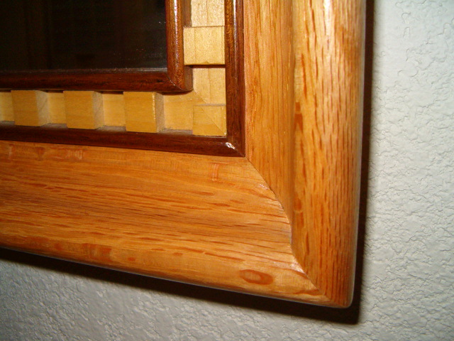

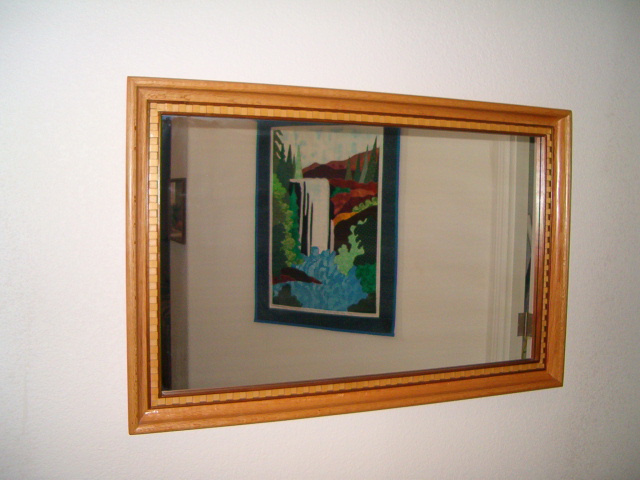

I have wanted to post my endorsement of the Shopsmith Shaper attachment - have been stalled in doing so for fooling with another computer issue.
I love the shaper and in particular the 6 piece cope and stick set (505937) SS calls it a complete cabinet set. It can be used on 3/4" wood as well as 1 1/4" (I think)(maybe 1 1/2") outside doors. It is a little mind boggling to set up, but works like a champ.
Other cutters can be used following a first cutter to give all kinds of interesting shapes on things like picture frames. Sometimes just using a second cutter to enhance (alter) the outline of the first makes a startling change.
The shaping package (555170) is the first add-on that I bought for my Mark V. It hasn't been used much lately, but it will soon. I had forgotten how much fun it is, and in my opinion, sometimes more desirable than a router. For one thing, the dust collection through the bottom of the table is very efficient.
Here is a couple photos of a mirror frame partially made with the shaper. The oak was shaped then there is some dentil molding of poplar sandwiched between two layers of walnut.

Thanks, for your kind words! BUT! Please don't miss what I was trying to illustrate. What I was trying to point out (should have said this earlier) was - the shaper can make shapes that I just don't have router bits to do. In fact, I don't think I could make these shapes with a router, even if I had the proper bits!
That frame (the outside edge roll) sits almost 2 inches proud of the wall, and the curves are milled from one piece. I know it can be duplicated, because the mirror frame was made in '99 and a similar, smaller picture frame was made in 2004.
I don't remember how many passes had to be made to form the frame,... I think 5. One on the table saw and 4 on the shaper.
