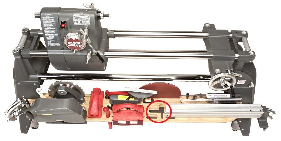

Note the mounting for the upper Guard for the two more common Mark V 500 Saw Blade Guard sets below.
_ .
The odd shape of that hole in the Accessory Shelf may be for those two upper Guards.
You said
That makes me wonder if the opening by the Fence shown in the red circle below is for the different Mark V 500 Upper Saw Blade Guard ends to sit in.The one in my original post looks like it will take the 500, 520, and 520 upper guard.
_ .
_ .

It's certainty for the one in second photo. That's the one I have and the cutout I ended up make is very similar to the one circled. That's why I say the shelf in my original post will work with (at least some) 500s. Can't say about the earlier 500 guards
