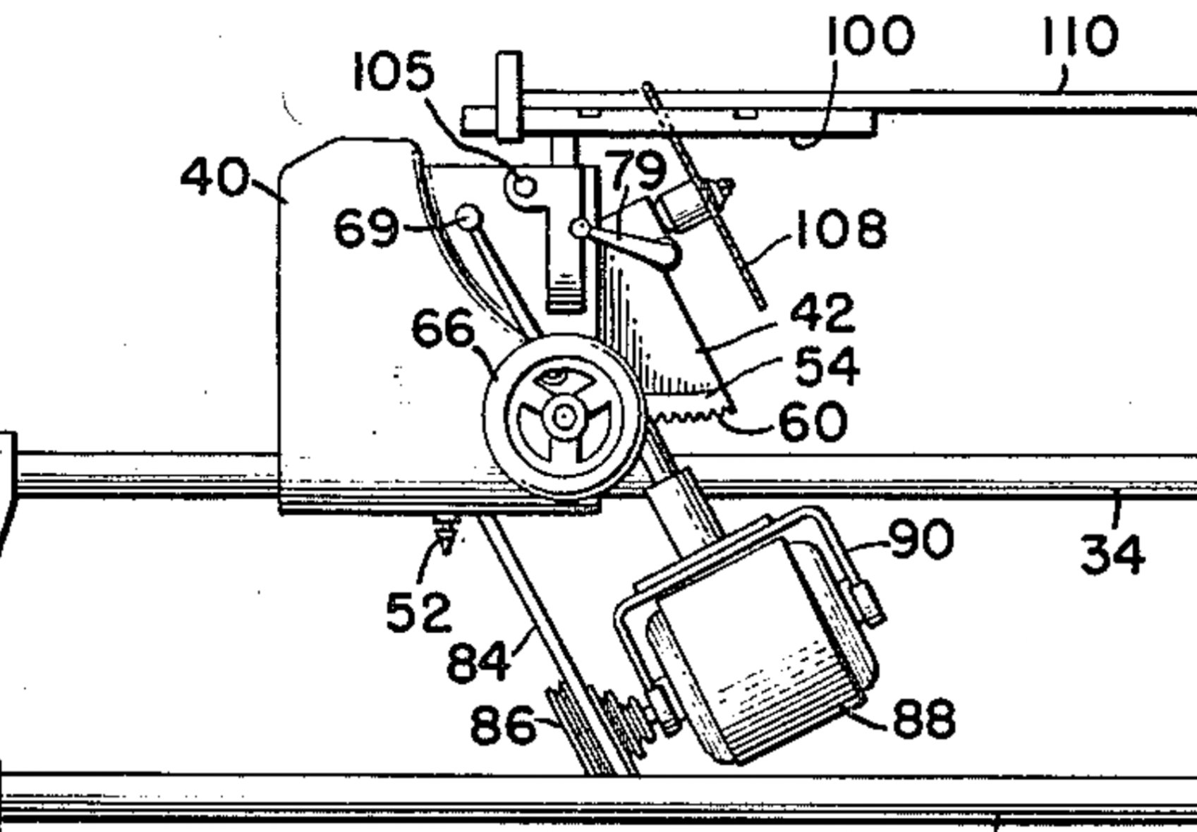

A tilting blade multi-purpose tool was patented years ago. Don't know if it ever came to market, but it also featured double-tilt, just like the modern Mark 7.

thedovetailjoint wrote: Wed Nov 01, 2023 8:31 pm A tilting blade multi-purpose tool was patented years ago. Don't know if it ever came to market, but it also featured double-tilt, just like the modern Mark 7.
You've mentioned this patent existed before. Somebody has probably thought of every reasonable multi-purpose machine concept and I'm sure some that are unreasonable also. This one adds one axis of rotation, machines can get busier than that. The RAS head could swivel on 2 axes and slide on a rail too.
Do you have the entire patent? Do you know if 60 or 54 is a trunnion? (looks like both numbers point to the same part)
