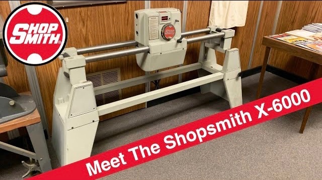

I recently posted a video about the Shopsmith prototype X-6000 machine on the MyGrowthRings Youtube channel. This machine was on display at the recent 75th anniversary get-together at the factory. A few of us have been chatting about it in another thread, and I think it deserves it’s own thread here.
Catch the video at this link: https://youtu.be/_Kuy7wGzcLI?si=tAQQ9BMnsziyiE_4

I'm glad someone started a thread on this subject. So, IIUC, this prototype led to the 510 but none of the headstock improvements found their way into production then or in the subsequent ~40 years.(?) Including, but not limited to, a quarter (-ish) turn wedge lock similar to (or same as) the one on the 510 and on carriage. And a 2HP motor (I presume to be AC Induction ball bearing type). I find both surprising, to say the least. If I was SS, both of these would be available as upgrades ASAP. I like the visible confirmation of locked or unlocked on the way tubes and think that is safer. More power speaks for itself.
Very good video, Scott. Bringing the patent info into it made it really clear what they had done and why.

I agree. It is very disappointing. Especially for me, because they could have brought this out around the timeframe shortly before when I purchased my 510. I get by with my 510 as-is, but a 2HP motor would have been nice for the 8/4 lumber that I use often. Would have really liked the height adjustment, but in the other direction as Scott mentioned. Still having height options, no matter which way is helpful for many owners. I would really like to know what caused this prototype to be killed and never brought to market in any form/fashion. It seems like carrying over a few features from it to the 510 was kind of a "let's salvage something from this prototype" effort in my mind, less the "oh it lives on somewhere" sentiment. We will probably never know the why though. Wish it had come to market...

It looks more like a prototype of one of the Shopsmith clones than it does a Shopsmith.

The X-6000 has variable and variable speed. Scott has said someone designed a Shopsmith type headstock that can tilt. I don't think it's all that practical but a headstock could pivot on an axis between the way tubes that would allow a left tilt of the sawblade and other rotary tools mounted on the main spindle. I think a cabinet saw version of the Shopsmith that has the headstock mounted on trunnions could maintain most current Shopsmith functionality except for drill press mode without going totally Rube Goldberg.

Thank you for the video presenting the X-6000. I like the comparisons to the Mark V 510 (and 505 for that matter) that appear to have come from the X-6000. This is an interesting part of the Shopsmith tool evolution and I am sure there were others.
I believe I understand the thinking at Shopsmith Inc. as to why the X-6000 never came out as envisioned. The Mark V had been a mainstay for the companies since its introduction, except for in the 1960's when the Mark VII became more popular. The two Mark tools, the Mark 2 and the 1960's Mark VII both were in production for only a short time. Even though the Mark VII pushed the Mark 5 out of production in 1964 its sale dwindled down soon after. Having the backward engineering available for upgrades to all earlier made Mark 5/V's has always been a plus. With more than 10 times as many Mark 5's having been made than Mark VII's, to me, it makes sense when Shopsmith Inc. was formed in 1972 that they brought back the Mark 5 and over the years continued to build on that tool with so many upgrades. If the X-6000 had come out and ended up replacing the Mark V there would be many more Mark 5/V tools collecting dust in the corner of workshops.
