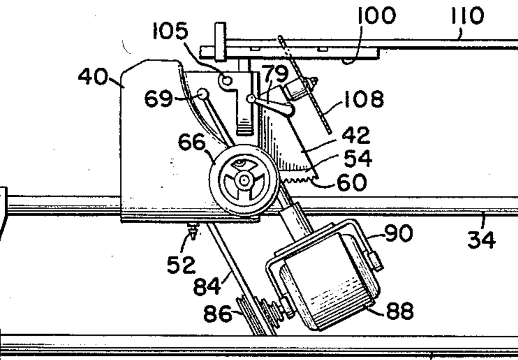

But I can't envision a tilting arbor that eliminates the need for a tilting table on a multifunction machine.
What do you see as a problem with a tilting blade? It would have to allow the sanding disk and other rotary tools to be mounted and fit in the table slot, but then you could do perform all the same operations with the table remaining flat while the blade is tilted. You probably wouldn't be able to tilt both left and right but the Shopsmith is limited that way anyway. What might seem odd is that you'd rotate the saw blade to tilt but raise the table up and down to change the blade height.

A tilting blade multi-purpose tool was patented years ago. Don't know if it ever came to market, but it also featured double-tilt, just like the modern Mark 7.

thedovetailjoint wrote: Wed Nov 01, 2023 8:31 pm A tilting blade multi-purpose tool was patented years ago. Don't know if it ever came to market, but it also featured double-tilt, just like the modern Mark 7.
You've mentioned this patent existed before. Somebody has probably thought of every reasonable multi-purpose machine concept and I'm sure some that are unreasonable also. This one adds one axis of rotation, machines can get busier than that. The RAS head could swivel on 2 axes and slide on a rail too.
Do you have the entire patent? Do you know if 60 or 54 is a trunnion? (looks like both numbers point to the same part)
