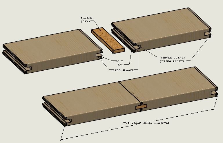

SteveMaryland wrote: Tue Dec 12, 2023 10:21 pm Well, I just don't want to buy the Freud tool if I can do a better joint without it. Using a finger joint to make ornamental molding is one thing, but I want to get material that is load bearing.
OTOH, the Freud tool would save a lot of work. But can't use it on a Shopsmith without a speed increaser or a router. The joint I described could be made without either.
Essentially, the joint I have illustrated above amounts to a combination of a tongue-and-groove joint + a splined joint. Each strong separately, and likely much stronger in combination - stronger than any other joint in the same volume.
I'm not sure I would trust either the Freud finger joints or long box-type joints to make load bearing beams unless I glued another length of wood, similarly constructed, on at least one side (face) of the joint and staggered all the joints, resulting in a beam twice as thick as the original wood, which requires even more wood.

As for the labor involved, the combination joint I showed above is maybe not the best. So let's spring for that Freud finger joint cutter and do a revised combination joint, as shown below.
FINGER JOINT DESIGN STUDY 4.JPG (49.17 KiB) Viewed 26312 times
FINGER JOINT DESIGN STUDY 4a.JPG (39.58 KiB) Viewed 26312 times
I am thinking that a hardwood spline would provide added strength, more strength than SPF. And yes, the interdigitated "fingers" above and below the spline, if well-fitted, glued and clamped, should be nearly as strong as the original fibers. It is the outer fibers that take most of the bending stress.

My money is on correctly created finger joints.

JPG wrote: Fri Dec 15, 2023 12:21 am My money is on correctly created finger joints.
I think so too...the spline seems like "belt and suspenders"
Idaho Panhandle
Re: Glue-joining of Cutoff Pieces for Lumber Recovery
They ARE strong and require little sacrifice of length.
However glue is the possible weak link. Using 'interior' glue outdoors WILL result in separation.

I think the finger joints will be fine. Of course the glue must be right for the application.
I think there are problems with the proposed modification to include a hardwood spline in the joint and not enough benefit to justify the extra work.
