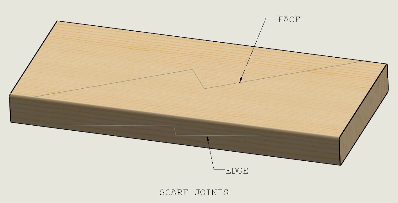

Just curious...why not consider scarf joints? With a 12 to 1 ratio the simple scarf is easy to make, nearly invisible and should be plenty strong. Finger joints are great...but to join lots of cut offs into a few long pieces, scarfing would be quicker and not require any special jigs or tools. Disclaimer: I do not work for the Scarf Joint Industry, this is just me wondering.

Re: Glue-joining of Cutoff Pieces for Lumber Recovery
Ed, not sure which sort of scarf joint would work. See attached illustration. Which one did you have in mind?
Looks like if I took two scraps and joined them with a scarf, I would wind up with a piece not much longer than the original scraps. Lots of glued area however...
