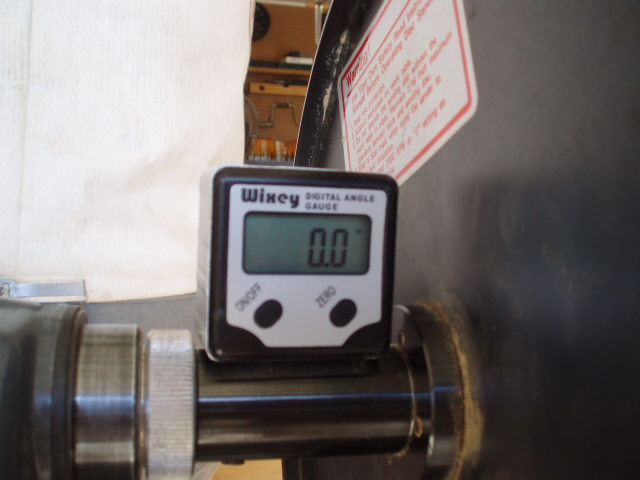

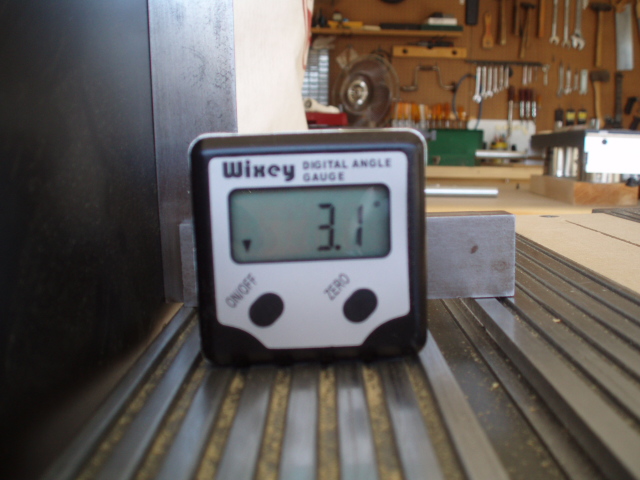

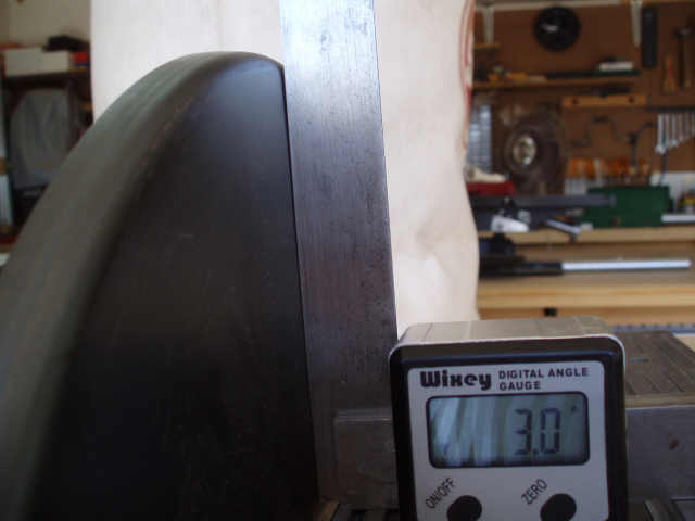

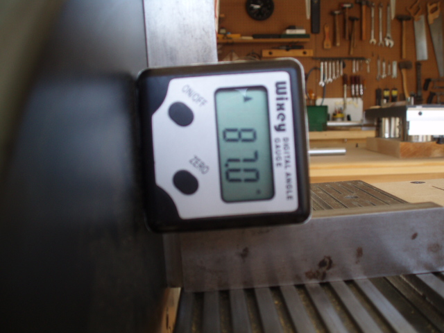

I don't think you were asking me but I have a comment anyhow. NO, the Wixey does NOT indicate 4 degrees. My Wixey indicates 3 degrees.JPG40504 wrote:Does Wixey say 4.0 degrees???
[ATTACH]4449[/ATTACH]
[ATTACH]4450[/ATTACH]
[ATTACH]4451[/ATTACH]
[ATTACH]4452[/ATTACH]
- P5110027.JPG (123.76 KiB) Viewed 5396 times
- P5110028.JPG (137.4 KiB) Viewed 5388 times
- P5110029.JPG (126.67 KiB) Viewed 5384 times
- P5110030.JPG (125.03 KiB) Viewed 5386 times
- Posts: 35598
THANK YOU! I did/do not care which/whose Wixey spoke/speaks. You have confirmed my own observations(without a wixey). The SS literature(when it was printed) states "precise 4 degrees". An overstatement to be sure!:)dusty wrote:I don't think you were asking me but I have a comment anyhow. NO, the Wixey does NOT indicate 4 degrees. My Wixey indicates 3 degrees.
