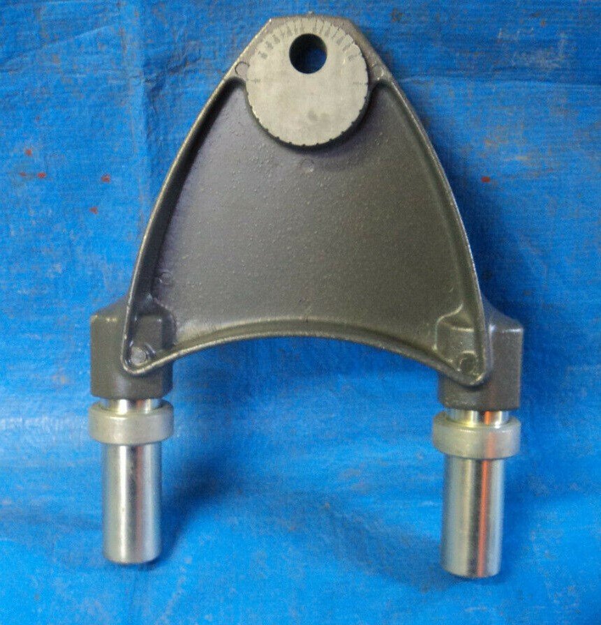

Can someone identify these for me. I numbered the pics.
- IMG_0092.jpeg (307.5 KiB) Viewed 5278 times
- IMG_0091.jpeg (334.11 KiB) Viewed 5278 times
- IMG_0090.jpeg (350.63 KiB) Viewed 5278 times
- Has a flat side.
- IMG_0089.jpeg (294.79 KiB) Viewed 5278 times
- IMG_0088.jpeg (392.3 KiB) Viewed 5278 times
- IMG_0087.jpeg (373.51 KiB) Viewed 5278 times
- IMG_0086.jpeg (417.43 KiB) Viewed 5278 times
- The thinner send is square and hollow.
- IMG_0085.jpeg (404.85 KiB) Viewed 5278 times
Re: I got a new to me mark

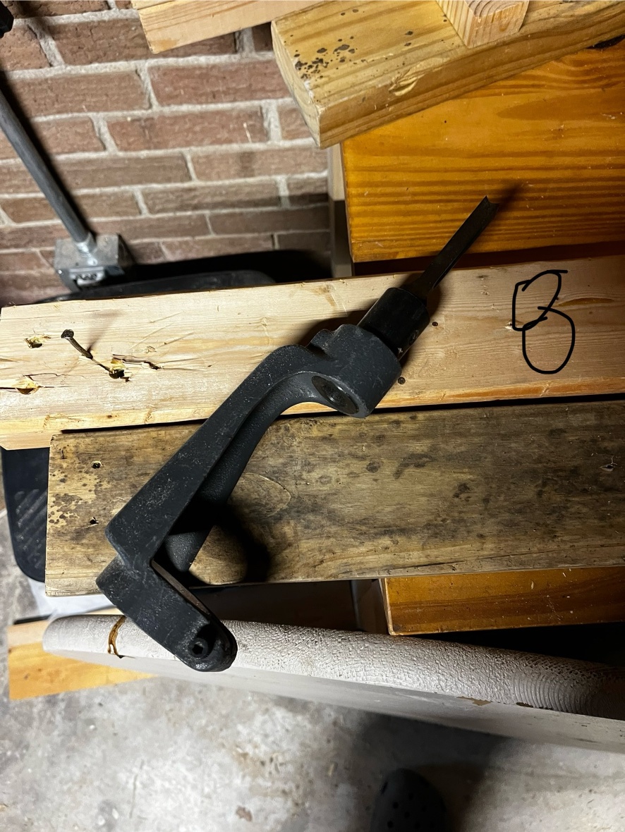

#8 is a morticing attachment. Not sure what is sticking out of the bottom.
#7 is the hold down for the morticing attachment.

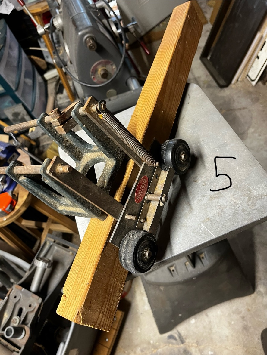

#5 is a Rip-Strate. Not made anymore, it's a device to aid ripping boards by keeping them along the fence and stopping kickback.
#4, not sure. Might be part of the morticing attachment hold down.

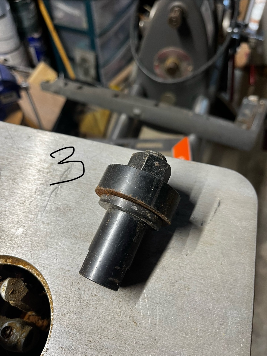

#3 is a universal arbor. Could be 1/2" or 5/8" spindle. The half inch allows you to mount saw blades, grinding wheels, etc. with a 1/2" hole. The 5/8" is used for shaping tools. Maybe something else I forgot too.

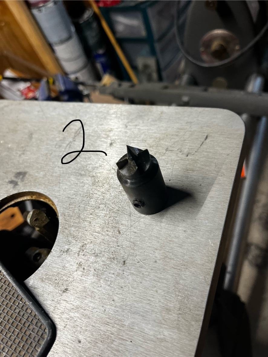

#2 is a lathe center headstock center for small diameter turning.

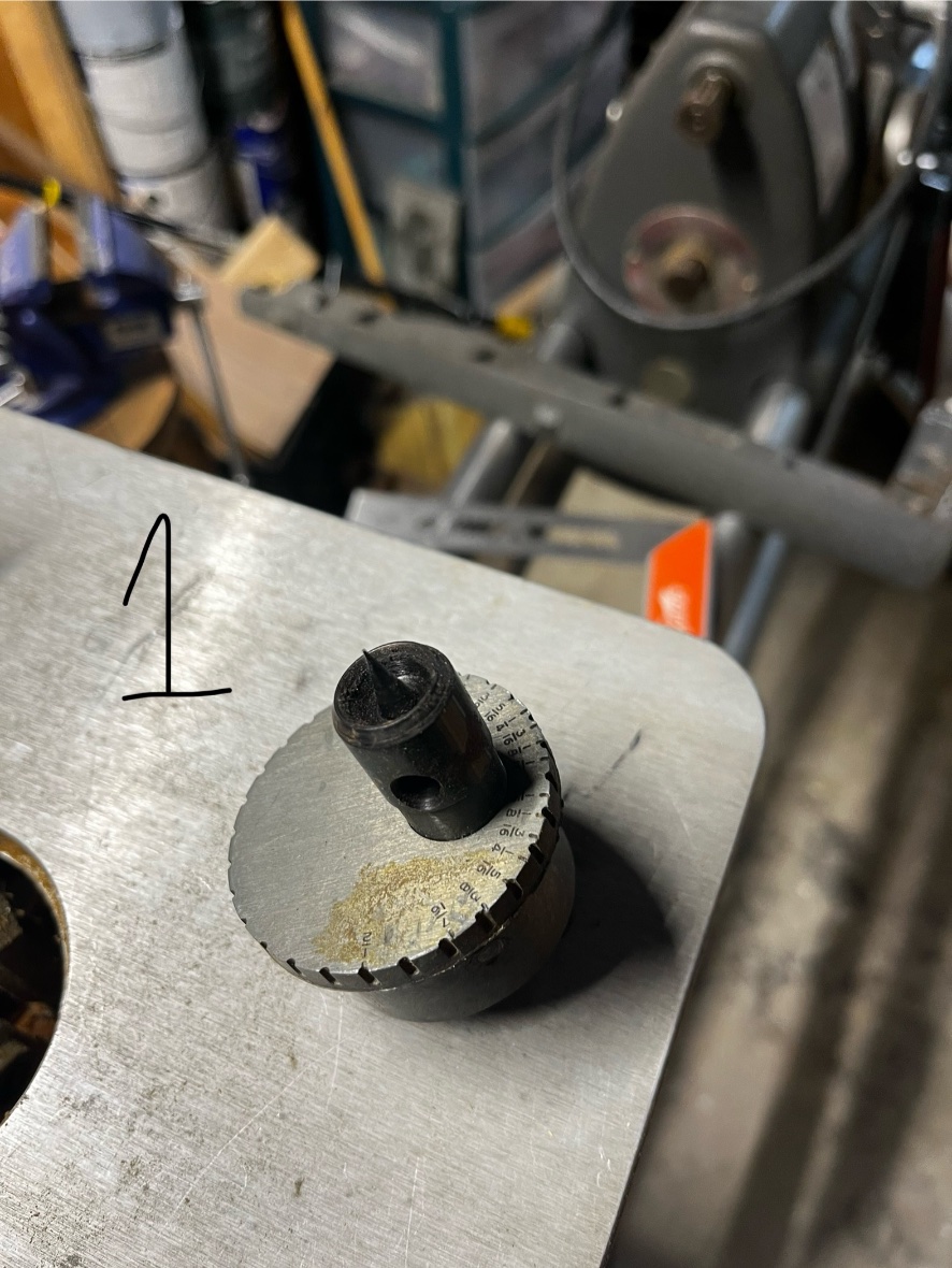

#1 is a tailstock insert that looks like it has a lathe live center stuck in it.
Ed from Rhode Island
#1 The #2 Morse taper eccentric for the tail stock with a dead (cup) center installed for lathe turning.
#2 The drive center that mounts to the head stock for lathe turning.
#3 Moulder/dado arbor missing some of the washers.
#5 Ripstrait stock guide used with the table saw.
#6 Old style hold down. Used to hold stock down to the table for various operations.
#4,7,8 Parts for the hollow chisel mortising system.

This link should take you to a Rip-Strate manual download: download/file.php?id=52836

Ed, I think what’s sticking out the bottom on #8 is actually on that piece of wood under the mortising attachment. Thanks all!
- Posts: 35598
The black thing sticking out of the mortising attachment (8) is a mortising bit chisel.

For reference.
#1 the picture below shows the Tailstock Eccentric in place. As has already been said it is a "Dead" Cup Center inserted into it in your picture.
_ .

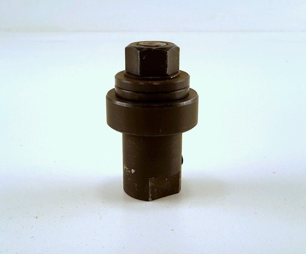

#3 is the 5/8" Universal Arbor, later known as the Molder Dado Arbor, part number 505506 and a complete one is shown below.
_ .
#4, 7 & 8 are parts of the Mortising attachment and a picture of some of the different era attachments are shown below. #4 and 7 are the Hold-down parts. The Hold-Down Post goes into the hole in the top of the Fence for your Mark 5 held in by the set screw. The current Hold-Down shown below has the addition of a "T" Slot nut at the bottom of the post for the newer Table Systems having "T" Track Fences. There is/was an upgrade "T" Track Fence available for the Mark 5/V 500 original Table System.
_ .
#6 is a Hold-down set up but not from Shopsmith. I have a very similar one, if not the same, from Craftsman (Sears) I bought for my Craftsman Table Saw years ago.
_ .
_ .
_ .
